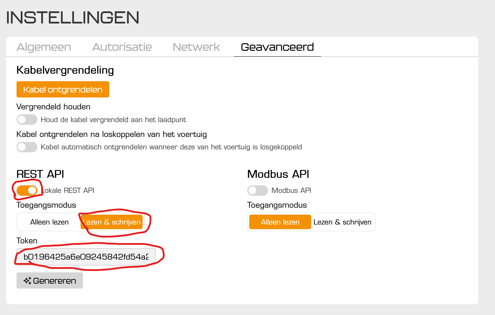

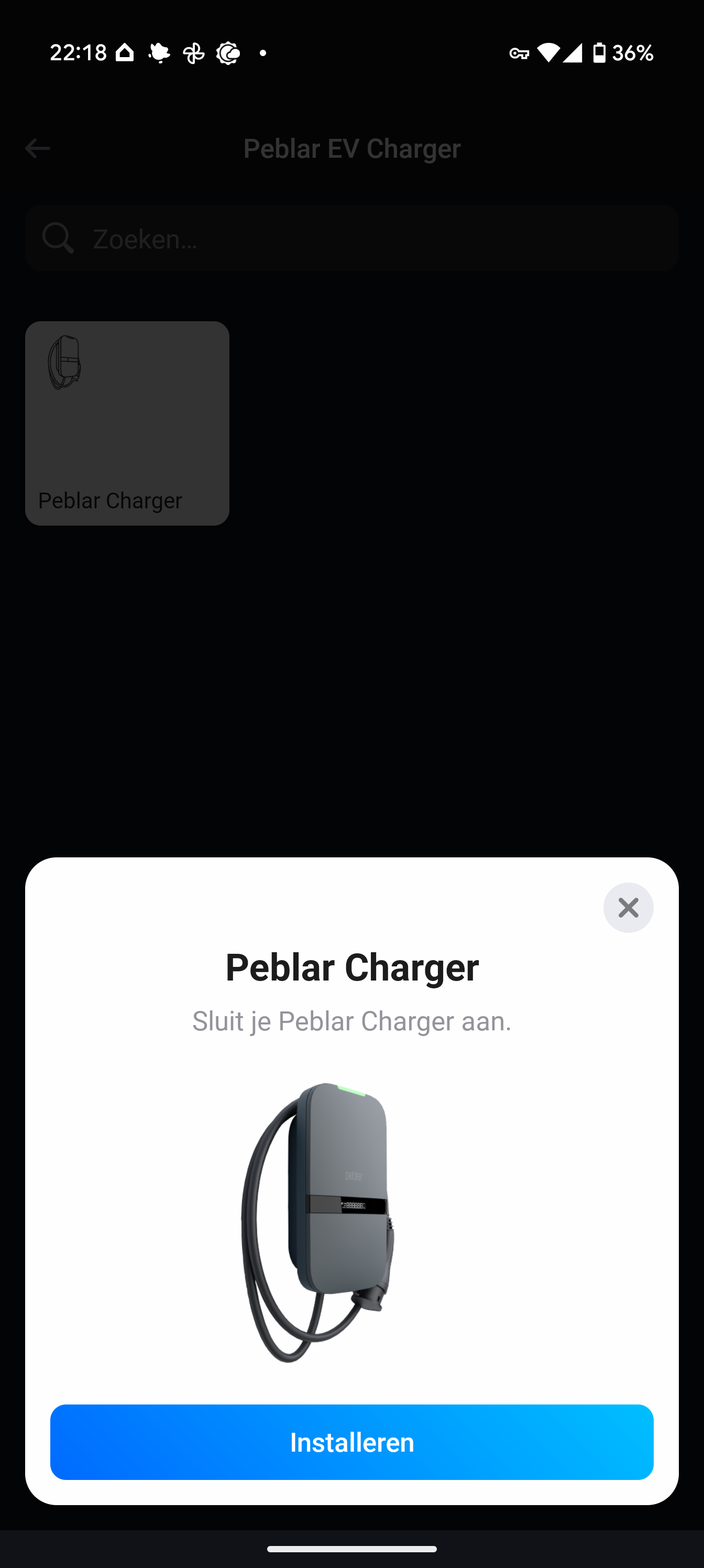

How to add a device
On your mobile phone or computer go to your Peblar charger and login,
go to settings, advanced and enable the REST Api with read/write access and copy the token.
Then write the IP and token down or copy it over to the Homey app:
The Peblar web-login password is optional. Without it, the normal REST API features still work. If you add it, extra features like smart charging modes, LED brightness, buzzer volume, firmware information, and reboot become available.

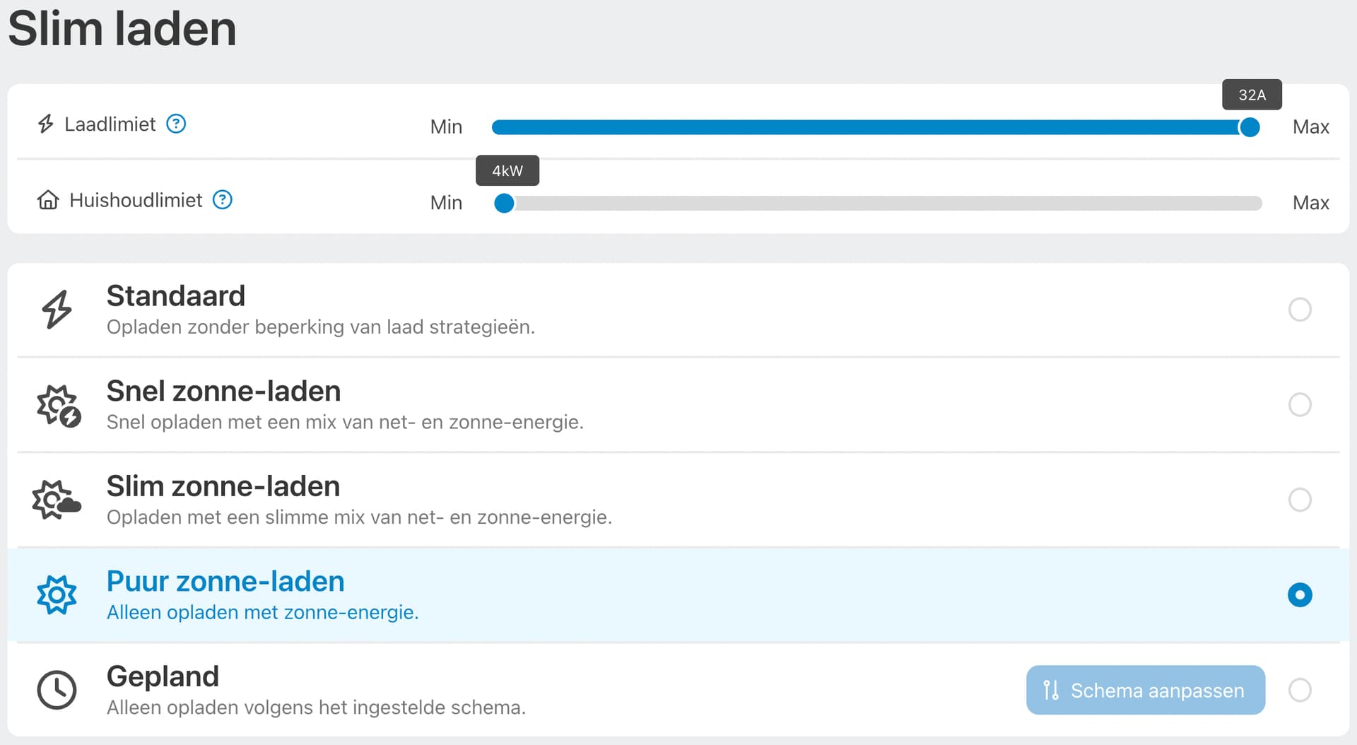

This charger has a bunch of useful smart charging sliders and modes.
Right now I’m using a Homey Script that logs in to the webinterface and manipulates these modes based on conditions outside of the charger (so for example when the prediction is sunny: switch to “pure solar charging” quicker).
Not sure how difficult this is to implement, but it would make this app infinitely more useful if users could pick charging modes and adjust charging sliders from inside Homey (instead of just turning charging on or off):

Sorry my explanation was not super clear. By “sliders” I specifically meant these:
It might be that you are not seeing these in the web interface yet, because they are part of a quite recent update.
Essentially what they do is:
  1. Laadlimiet: the actual hard limit of the charger. For example on one phase 32A would be around the recommended maximum (in Belgium). This amounts to a charging speed of around 7400W. This control is also in the Home Assistant integration:
    But to be fair, I have not found a good use for it yet, although I can imagine some crazy flows where you might want to adjust this dynamically? Or put the charging to 0 perhaps?
  2. Huishoudlimiet: This one is specifically to avoid extra costs for “Piekverbruik” in Belgium as I understand it. Essentially what it does is keep you household Watts under a certain limit (If I were to run my dryer while charging the charging speed would decrease so the Watts usage in the house stays on the same level). You can see this one as the defacto limit for the “Standaard” charging mode. Actually I’m also not changing this one as I like to keep my peak usage limited and almost always charge slowly.
So perhaps, long story short, the sliders might not be super useful to change trough homey. But if it’s easy to implement maybe it’s worth adding?

Yesterday I installed it and tested it. I can see the charger and the status and power. However I van nog start or stop the charger. I get below error.
Hello! This is because you don’t have a write access most likely. Please check the first post to see how to turn it on.
It has to be set as below right?
Yes, are you also 100 procent sure your token is correct? Error 401 means unauthorized
I copied it, and I tried 2 different tokens. Could it be that authorisation is done via a third party? Manually I am able to change settings though.
