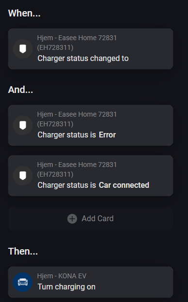

Do anyone have a good flow/solution to my problem?
My Easee charger is controlled by my power supplier (Tibber) who controls when to start charging.
I have an Hyundai Kona who goes to a deep sleep after a while without charging.
In most cases I put the charge cable in at around 18.00, but Tibber wont start smart charging before 23.00, by that time the Kona has ended up in a deep sleep, and Tibber/Easee cannot start charging.
Is there a good status or something that I can monitor to understand when Easee “starting” charging, but the car is not receiving? So I can trigger an charge event from the Hyundai APP in Homey?
I tried with a flow yesterday, that I thought would do this:
But when checking in Homey my charger was not set to Error, only “Car connected”(?). But I think that the status was the same from I inserted the charge cable (18.00)… I thought the Easee would end up in a error (or other) state when Tibber starts charging and the car don’t charge…
Hopefully someone has some input :slight_smile: Thanks!
And yes, I can create a flow that runs every hour between 22:00 and 02:00 for example checking if status is “Car connected” and then start charging… But I don’t have any clue if Tibber actually has told Easee to charge
