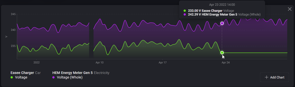

Hi, since 23.4. I’m not getting anymore updates on Voltage readings - can I influence it anyhow ?
Btw I was using version 1.3.1 and switched back to 1.2.9 to see any difference and it seems indeed 1.2.9 is working just fine

So I’m not sure what has happened, but suddenly for last 15 days I get Voltage not updated anymore, not even during charging. So when Charger is not used, it is reported as Not responding device by Homey (which might be alao used as keep-alive preventive check so that automation works every time).
Anyone else have the same experience? It’s probably due to some change on Easee side, the original app still reports voltage fine. Thx
The app simply sets the values that the Easee API delivers. Maybe Easee disabled some features after their days of downtime a few weeks ago? I can confirm that Voltage also said 15 days since last update for me.
The Homey app reads from Easee cloud, then Easee cloud based on some internal logic controls how frequently the actual physical charger synchronizes its data with their cloud.
This I have not experienced. I have two chargers though.
You might be right, because even original app strangely reports same values while real voltage is different…more over seems it’s not updating.
I will contact Easee. Thank you for additional inputs Richard.
I mean standard trigger “A device hasn’t reported for”, maybe you are not using it.
They confirmed it has been limited on their side and restrictions were just lifted. Now it gets updated in the app as well :slight_smile:
