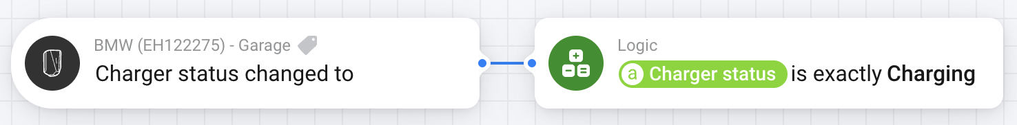

Can observe what you observe, would have to investigate the reason for it.
As a workaround, you can use the same trigger and add a Logic condition in the following step. The status the charger changed to is passed as a token that you can use in the Logic card.
I introduced a new trigger which works as you’d expect. The old trigger is still there with an updated text “Charger status changed”. Please give the test version a go.

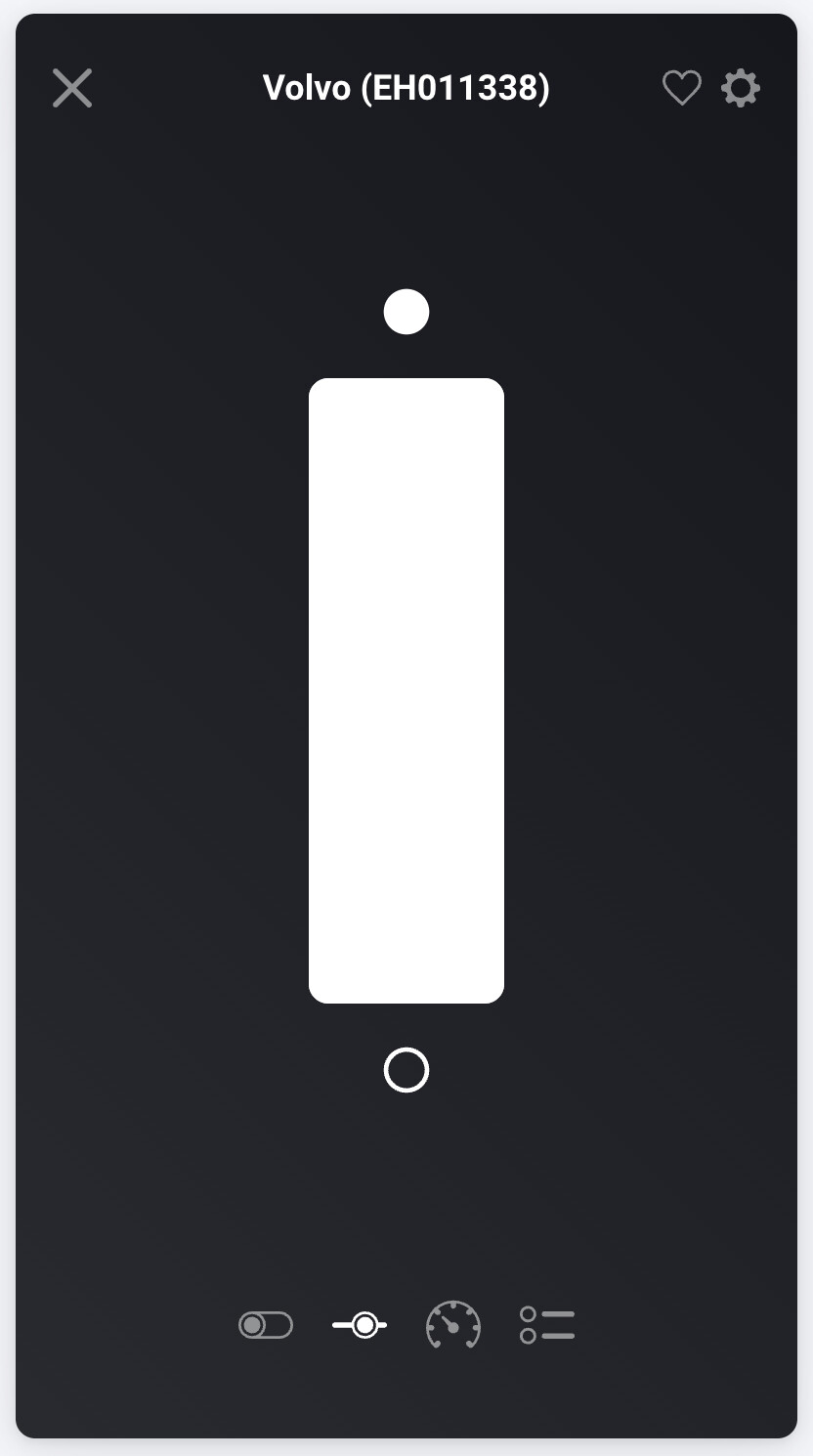

  • Setting the dynamic circuit current
    The same setting that for instance Tibber is using to control the charge current. Please note that this is circuit current, ie if you have multiple chargers on the same circuit this setting controls all of them.
    Visualized with a “slider” which is a little crappy, but don’t see any options.

Thinking of the slider for dynamic current, it will not report current value however, right? This might be tricky, it will be in “percentage” or how the max. value will be defined? Just thinking out loud.
It will report the current value, fetched each 15s from the Easee API, also visible in insights.
The value is in current, ie measured in Ampere (A). My comment about “little crappy” refers to the fact that the Homey UI doesn’t show the unit (A), nor displays the value of the slider. You have to guess the scale, so I understand it is confusing. The max value of the slider is the circuit fuse size as defined in Easee, in my case 20A. The circuit fuse size is displayed under advanced settings on the device in Homey.

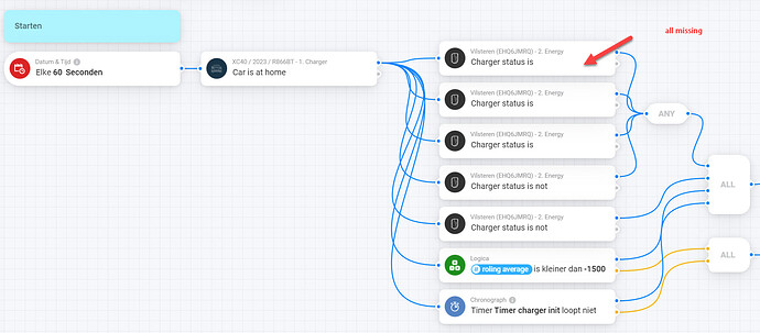

Since the update I have some weird issues in advanced flows.
Does anybody recognize this?
I have restarted homey and the app. Also tried more windows machines.
Creating a new condition it seems to work
I confirm, can observe the same, not only in advanced flows - I’m on version 1.4.7
obrazek
So this occurs for existing flows, but adding the same condition again then it works?
(Don’t experience this problem myself)
Yes that is correct. I already fixed the flow and it works again. Keep up the great work really like the app.
@Richard_B @Huub_Van_Vilsteren now I have realized, actually all those flows are broken thanks to this, I thought the conditions are just not appearing due to some internal Homey / cosmetic error…
When I test such flow, I get error :
obrazek
What is interesting, it’s not caught by Flow Checker - I will ask martijnpoppen if he would be able to catch this, but anyway it looks like all such flows have to be repaired - so it’s information to all users of your app, at least when using version 1.4.7, as it triggered breaking change.
Looked through the code now and understand the problem. Didn’t realize this before, I improved (or so I thought) the code and put all statuses in an enum in the code and used the autocomplete feature for this condition. The argument has the same name, but it caused a change in the id’s in the dropdown :grimacing:

If you want a slider with numbers you can use the thermostat UI interface instead but then again… it probably will look very odd :laughing: I agree the Homey UI is very limiting.
The other option would be to use uiComponent “picker” and have all 40 numbers encoded as enum values including the unit.

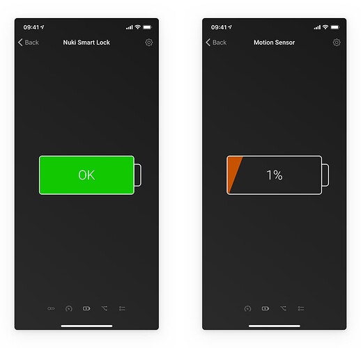

Speaking about new capabilities, maybe the measure_battery would be useful too?

This might be better than the slider actually since it doesn’t show any insight into scale or current value.

Please note that you will loose the insights if you make it an enum… so no graphs :frowning: …but I guess that won’t matter as you probably already get the graphs from the existing capabilities measure_current.p1, measure_current.p2 and measure_current.p3 ?
