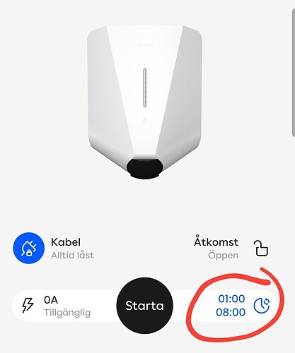

Anyway that we can see the possibility to change the schedule in the interface as well?
This is an API to override a schedule
/api/chargers/{id}/commands/override_schedule
Allows current session to charge immediately provided that schedule is the only mechanism stopping charge currently
There are also endpoints for what they call basic_charge_plan, to get, update/create and delete a charge plan. I’ll look into what can be done.

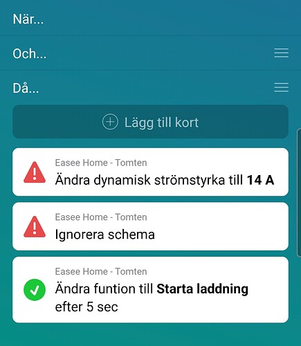

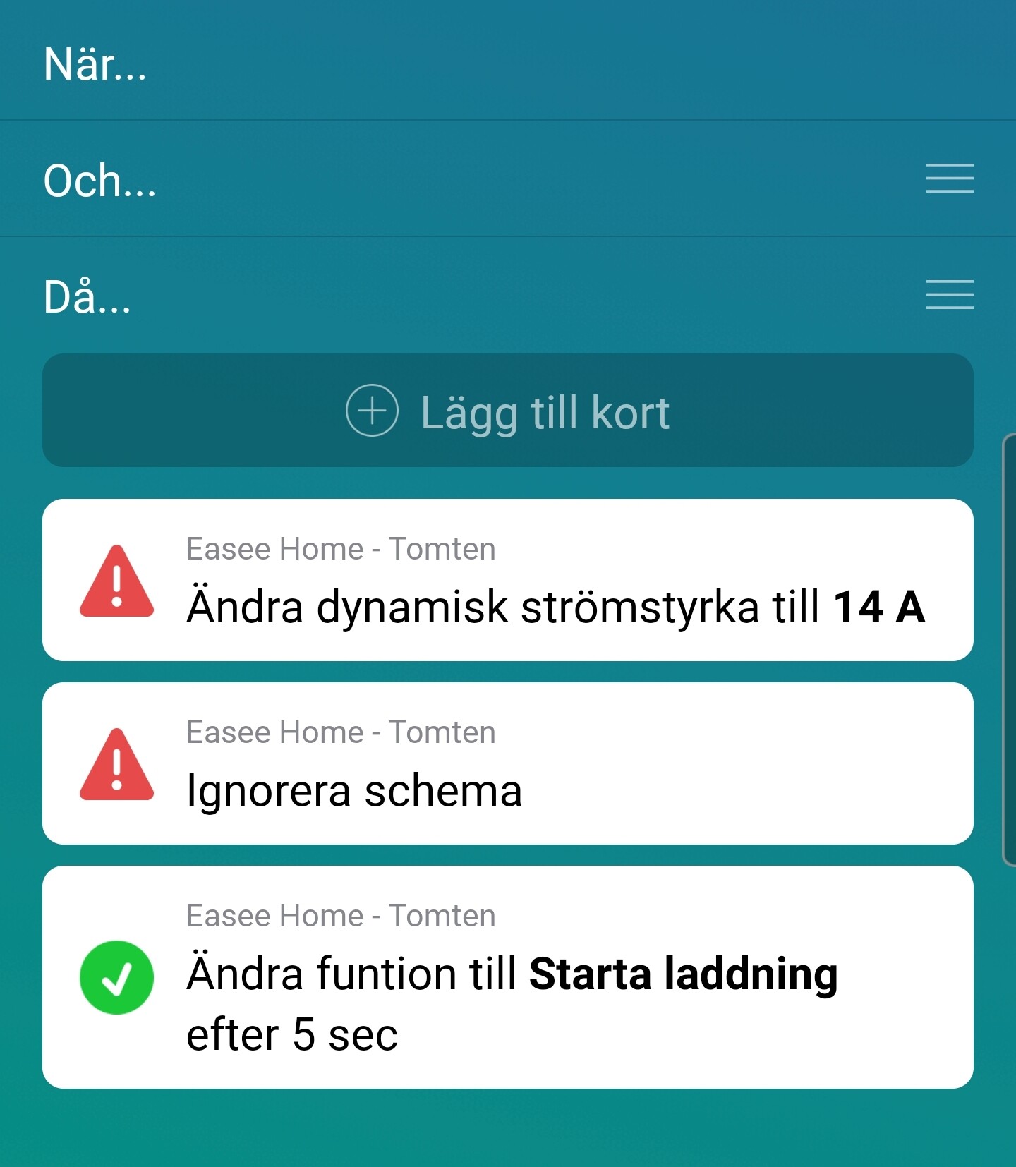

Yeah, I realize that something went wrong. But only thing I did was to run a flow, changing the allowed current.
Just for your info, I tested a flow looking like this, but it returns some errors:
2021-04-07 22:43:51
Error: POST ‘/api/chargers/EH663229/commands/override_schedule’ failed, HTTP status code ‘400’, and message ‘’{“errorCode”:410,“errorCodeName”:“ChargerDisconnected”,“type”:null,“title”:“Charger disconnected”,“status”:400,“detail”:"[Empty in production]",“instance”:null,“extensions”:{}}’’
at /lib/easee.js:476:39
at processTicksAndRejections (internal/process/task_queues.js:97:5)
