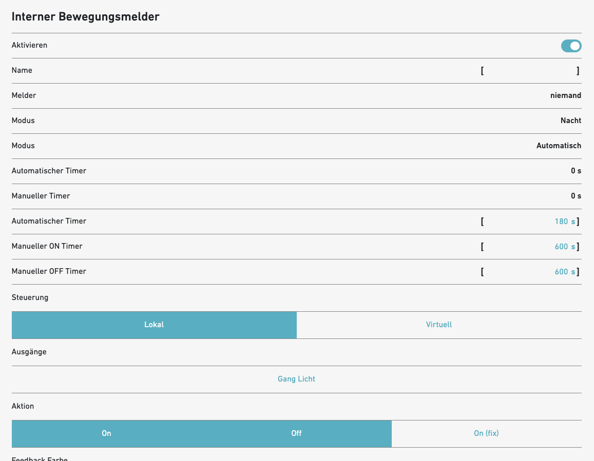

Check your configuration, it should look like this:
New test version 2.0.4 :
  • Icons refactored
Yes, my settings look exactly like this. The only difference is that when I select “Local” under Control, the message “No local motors or outputs available” appears. But even if I change the control to “Virtual” and add the DINGZ switch again, the motion sensor does not appear.

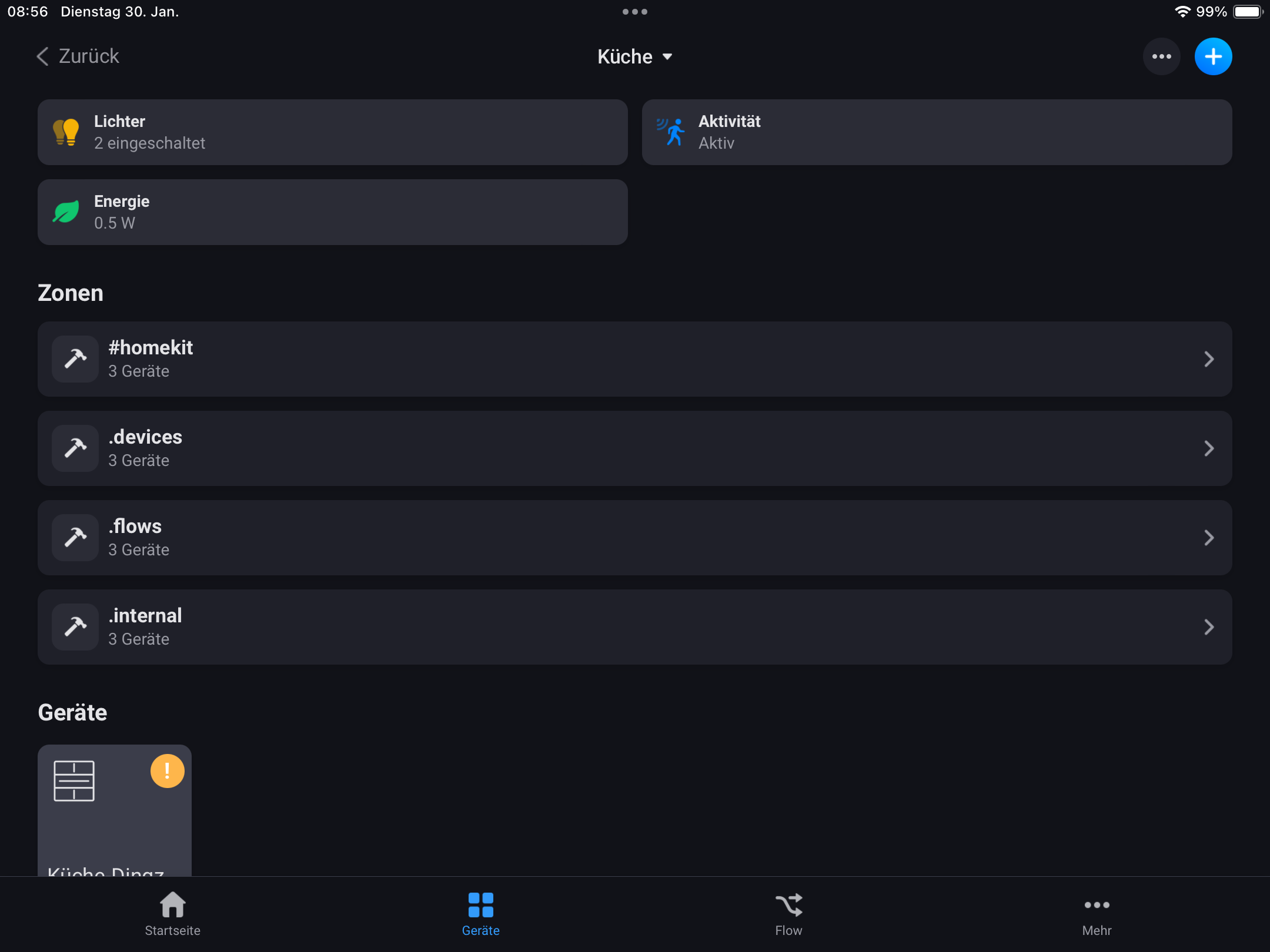

Hello Chris
Except for the zone activity of the motion detector, everything is working perfectly, thank you very much for this app.
My installation is as follows:
  • App version: 2.0.6
  • dingzSwitch model: Dingz plus
  • dingzSwitch firmware: 2.1.1
  • Homey model: HP 2023
  • Homey version: 10.2.1
  • MQTT broker: MQTT Broker (Homey App Store)
  • Broker version: 3.0.2
In your post Nr. 115 from October 2023 you gave me the following answer:
Athom has a bug in their code and they are informed and when it’s fixed then you’ll notice it already.
Now we are at the end of January and still nothing has changed, the motion detector still does not appear in the activity display. As I wrote back then, no matter which other devices I add to Homey (in this time several others, also newer date/appearance), all appear in this activity display, only the Dingz motion detector does not.
Now I would like to ask you:
  • Are you sure that the error is with Athom and not in your app?
  • If so, have you reported the error or can you ask when Athom will have fixed this error?
    I’m just wondering because it really works with all other devices. What also makes me wonder is the fact that in the Dingz Homey app I have the option to exclude it from the zone activity or not under the advanced settings in the motion detector.
    I look forward to your feedback and thank you for your efforts.
I already tried to explain to you last time that I neither work for Athom nor have any influence on the order in which the errors in the Homey are fixed
And now to your accusations:
Since the source code of the app is available for everyone to see, you are of course free to check it and report the “error” to me if necessary.
In the Homey Slack channel from 29/10/2023 you can check that I actually informed @Jero that there is a problem with the zone activity.
BDW:
Have you noticed that the motion messages are entered in the device timeline, or that the motion is triggered in a flow and “last but not least” the motion messages are also displayed in the Heimdall app?
If this is the case, then the app works…
