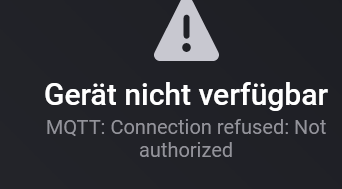

Hi Chris,
I initially used the app version V1.3.1. Everything worked perfectly with this, except that the blinds are shown as closed in the Homey app when they are open and vice versa. So I removed everything and restarted completely according to your instructions with V.2.0.6. Unfortunately, I can’t get the dingz to work.
– App version: v2.06.6
– dingzSwitch model: dingz plus
– dingzSwitch firmware: 2.1.1
– Homey model: Homey pro 2023
– Homey version: 10.3.2
– MQTT broker: MQTT Broker
– Broker version: 3.0.2
– Simple Log: 3.0.33
Do you have any tips on what I’m doing wrong?
Thanks,
Adrian
Hi Adrian
Have you changed the password in the MQTT Broker?
If so, then you also need to do this in the settings of the Homey app and then restart the app.
Chris

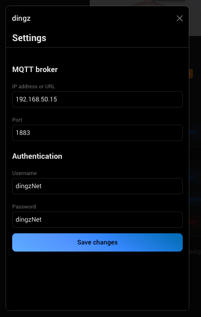

Strange, but you have changed the user/password (no longer the default dingzNet/dingzNet), because it looks like you have no authorization in the broker.
BDW: I noticed that the user in the broker is called “dingzNET”, is that correct?
Yes, User dingzNET and Password dingzNET. Is this wrong?
Not really, as long as you use the same user ID and password in the dingz app and in the MQTT Broker.
If by the dingz app you mean the Homey dingz app, then I have the same username and password in both places. (Homey dingz app & broker)
Yep, In the app settings:
Now it works. I had to adjust the IP according to your printscreen. Localhost does not work and under Notes you wrote the following IP:
If you use the Homey MQTT-Broker, then it is sufficient to enter the URL “localhost” or “127.0.0.1” at MQTT-Broker settings, because the rest is done automatically by dingzNet.

2024-03-15T19:06:35.767Z;dingz;DingzNet > MyMqttClient > publish() > mqtt client not connected
2024-03-15T19:06:35.768Z;dingz;DingzNet > MyMqttClient > publish() > mqtt client not connected
2024-03-15T19:06:35.769Z;dingz;DingzNet > MyMqttClient > publish() > mqtt client not connected
2024-03-15T19:06:35.770Z;dingz;DingzNet > MyMqttClient > publish() > mqtt client not connected
2024-03-15T19:06:35.771Z;dingz;DingzNet > MyMqttClient > publish() > mqtt client not connected
2024-03-15T19:06:35.772Z;dingz;DingzNet > MyMqttClient > publish() > mqtt client not connected
2024-03-15T19:06:35.777Z;dingz;DingzNet > publishDeviceConfig() > publish > Error: [MQTT] Unable to publish: mqtt client not connected
2024-03-15T19:06:35.778Z;dingz;DingzNet > publishDeviceConfig() > publish > Error: [MQTT] Unable to publish: mqtt client not connected
2024-03-15T19:06:35.779Z;dingz;DingzNet > publishDeviceConfig() > publish > Error: [MQTT] Unable to publish: mqtt client not connected
2024-03-15T19:06:35.781Z;dingz;DingzNet > publishDeviceConfig() > publish > Error: [MQTT] Unable to publish: mqtt client not connected
2024-03-15T19:06:35.785Z;dingz;DingzNet > publishDeviceConfig() > publish > Error: [MQTT] Unable to publish: mqtt client not connected
2024-03-15T19:06:35.786Z;dingz;DingzNet > publishDeviceConfig() > publish > Error: [MQTT] Unable to publish: mqtt client not connected
2024-03-15T19:06:35.787Z;dingz;DingzNet > publishDeviceConfig() > publish > Error: [MQTT] Unable to publish: mqtt client not connected
2024-03-15T19:06:35.788Z;dingz;DingzNet > publishDeviceConfig() > publish > Error: [MQTT] Unable to publish: mqtt client not connected
2024-03-15T19:06:35.789Z;dingz;DingzNet > publishDeviceConfig() > publish > Error: [MQTT] Unable to publish: mqtt client not connected
2024-03-15T19:06:40.307Z;dingz;DingzNet > MyMqttClient > subscribe() > mqtt client not connected
2024-03-15T19:06:40.310Z;dingz;DingzNet > MyMqttClient > subscribe() > mqtt client not connected
2024-03-15T19:06:40.315Z;dingz;Dingz one FrontLED > registerTopicListener() > [MQTT] Unable to subscribe: mqtt client not connected
2024-03-15T19:06:40.319Z;dingz;Dingz one FrontLED > registerTopicListener() > [MQTT] Unable to subscribe: mqtt client not connected
2024-03-15T19:06:40.325Z;dingz;Dingz one FrontLED > Device added
2024-03-15T19:06:40.365Z;dingz;Dingz one FrontLED > Device ready
2024-03-15T19:07:14.336Z;dingz;DingzNet > MyMqttClient > publish() > mqtt client not connected
2024-03-15T19:07:14.338Z;dingz;Dingz one FrontLED > sendCommand() > [MQTT] Unable to publish: mqtt client not connected
2024-03-15T19:07:14.340Z;dingz;DingzNet > MyMqttClient > publish() > mqtt client not connected
2024-03-15T19:07:14.341Z;dingz;Dingz one FrontLED > sendCommand() > [MQTT] Unable to publish: mqtt client not connected
2024-03-15T19:07:14.343Z;dingz;Dingz one FrontLED > Set state > On
2024-03-15T19:07:14.356Z;dingz;Dingz one FrontLED > Set state > color: hsv(295, 94%, 100%)
2024-03-15T19:07:18.930Z;dingz;DingzNet > MyMqttClient > publish() > mqtt client not connected
2024-03-15T19:07:18.934Z;dingz;Dingz one FrontLED > sendCommand() > [MQTT] Unable to publish: mqtt client not connected
2024-03-15T19:07:18.935Z;dingz;Dingz one FrontLED > Set state > Off
2024-03-15T19:07:20.751Z;dingz;DingzNet > MyMqttClient > publish() > mqtt client not connected
2024-03-15T19:07:20.756Z;dingz;Dingz one FrontLED > sendCommand() > [MQTT] Unable to publish: mqtt client not connected
2024-03-15T19:07:20.759Z;dingz;Dingz one FrontLED > Set state > On
Have you really deleted all dingz-devices in Homey?
Then please add only one device, then I might find out where the problem lies.
BDW: Please send me the current configuration of the dingzSwitch via PM
@Adrian_Schmid
In my case, the DingzID was not the correct MAC address for the Dingz. This caused me problems with 2.0.6.
ev mal in den Einstellungen kontrollieren
