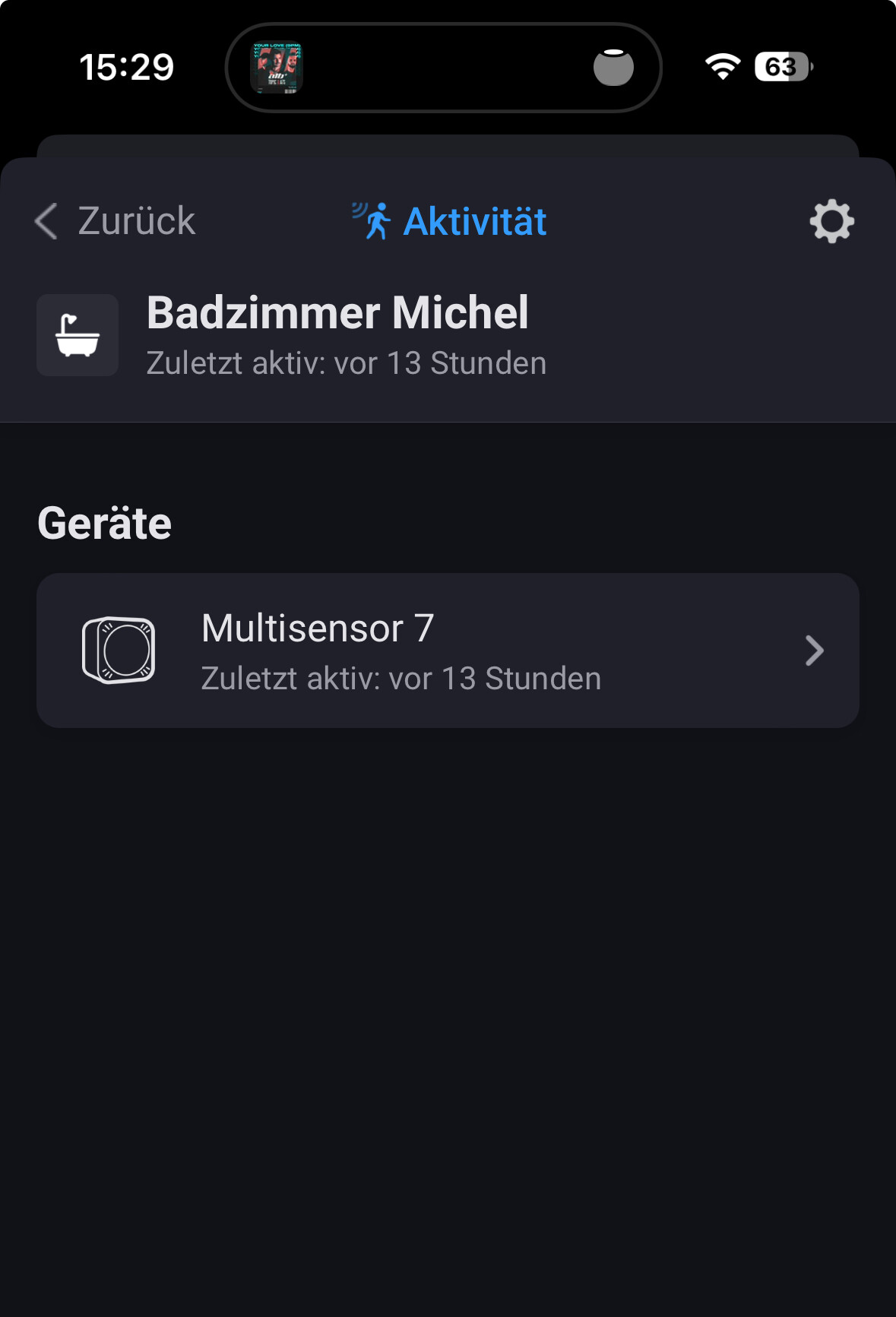

My Dingz motion detector is not listed in the activities, all other motion detectors are. Is that what you want or what can I do or what information do you need from me? By the way, he is reported in Heimdall. I want to use it to switch the light, which means that if zone XY is active, then light on, if inactive, light off.

The Multisensor is in the same room like the Dingz, but the Dingz Sensor is not aufgelistet💁🏻‍♂️
This is a (new) homey function, I have never used it. If you have installed the dingz device and it goes to active in the zone, then everything is OK from my side.

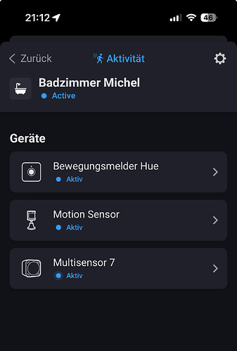

BDW: For me the activity looks even stranger
That’s exactly what it doesn’t do. The Dingz motion detector does not appear in the activities. If I move another motion detector into the “Bad Michel” room, then they appear there and also show the activity. is the same with the aeotec multisensor, hue motion detector and aqara motion detector.
No matter which sensor I move into the room, everyone shows the activity, except the Dingz BM.
