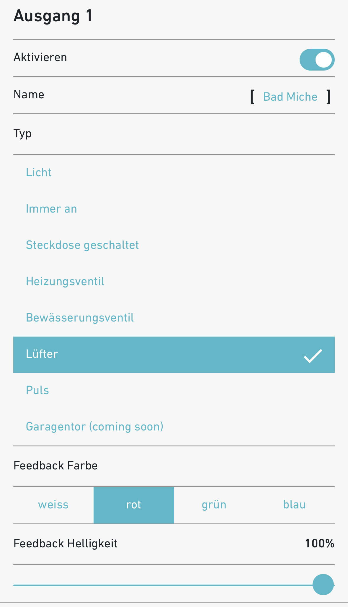

Good morning, I have configured one of my 4 buttons in the Dingz app as a “fan”. This now does not appear in Homey, the other 3 light buttons, the motion detector and LED appear. Is this intentional or am I making a mistake?
