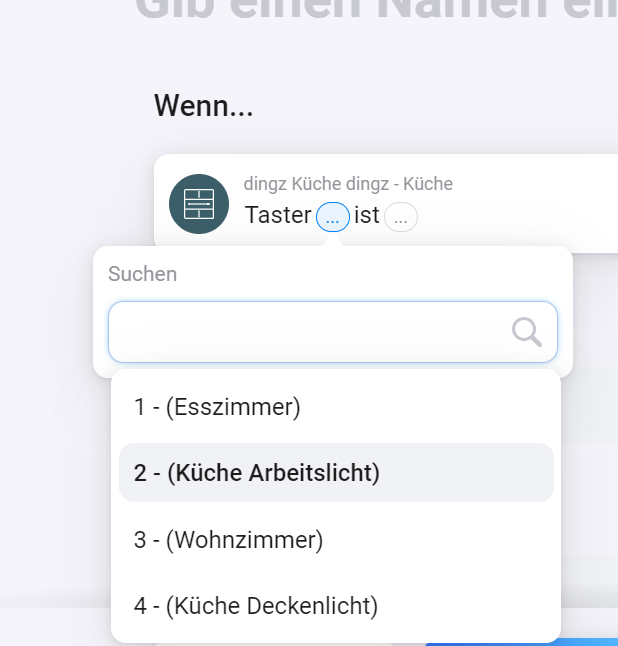

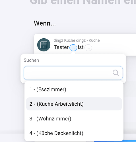

I saw that yesterday and then installed it as well. The Dingz are recognized and my actions run as usual.
Only I can not select the button in the flow and I did not know if I have to enter something in the search field.

The Dingz button in the flow can only be selected if the button in the switch is not assigned to an action/output.

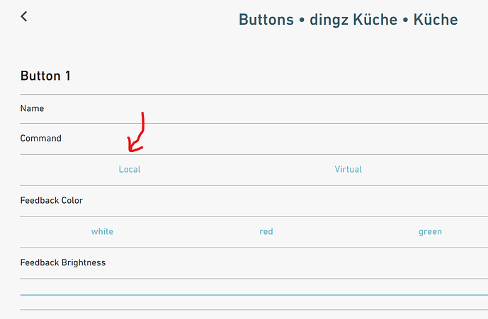

I have just executed your hints in the menu item again and have found the following.
After I cancel the selection in the command setting, the buttons also appear in the flow. I can execute the created flow from the app. Only the keystroke on the DINGS itself no longer works because the command is not defined.

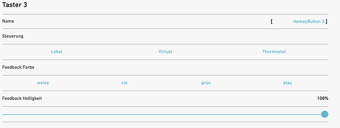

@ChrisG
I have another concrete question about “Command”. In German “Steuerung”
If I disable everything here, I see the buttons in the “Button … is …” where-card and i can create flows. These also work well.
But with this configuration the button on the DINGZ doesn’t work anymore. For this I would have to select either “local” or “virtual”. But then the button is no longer available in the “Button … is …” where-card.

This is a homey feature !!!
You already did it right deselect local and virtual, then it is a homey button.
