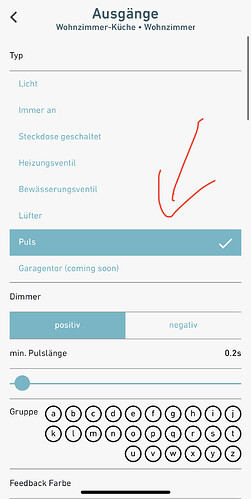

With Impuls I mean this:
It’s not a “normal” light but it works with an impulse for on/off. I don’t know, maybe it is a problem of my configuration.
Ok, I’m going to try.
Thank you & Gruss
Mauri
Hi Chris
I just tried the “puls” mode switches again. it’s definitely a problem with this setting on dingz. If I change the mode from “Puls” to “Licht” (see my previous picture) in the dingz settings, the switch is recognized. As soon as I change back it on “Puls” it doesn’t recognize it anymore. There seems to be a problem with this mode.
What can I do? There are no possibilities on dingz to change it, because I need this mode for my lights. And also because it worked with your old version.
Thx for your help.
Mauri

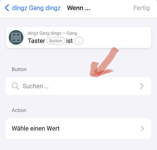

Good evening
I have the Homey Pro 2023 with the Dingz App 1.3.1 since today.
The Dingz are all configured and work as usual without Homey Pro.
Now I wanted to make a configuration in the Homey App for a Dings switch. Only I do not understand what goes into the field (screenshot). No matter what I enter there, the result remains empty. I had the same phenomenon in the previously installed version 1.2.5.
What am I doing wrong?
All buttons and outputs have unique names.
FW: 2.0.21
Best regards
Stephan
