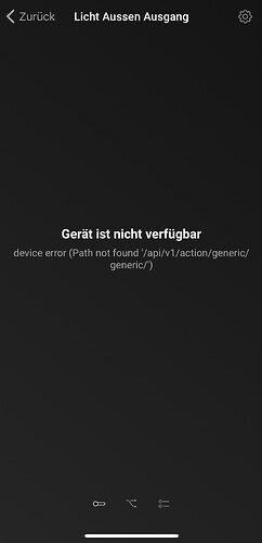

I just have updated a new Firmware (2.0.21) to my dingz devices. Since the Update I can‘t connect the dingz anymore.
Do you have any idea, what the problem is?
Thx for your help.
Mauri
Yes I did, you just have to read the first topic…
