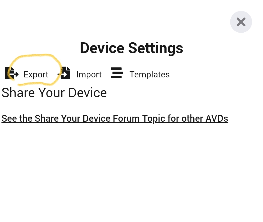

Go to the AVD’s settings:
tap Maintenance > Try to repair
Tap “Open share your device”
Then, tap “Export”
Cloning as new AVD:
At the Devices tab, go to a zone the original AVD isn’t in (when finished, it can be hard to determine what’s the original and what’s the clone).
Add a new AVD
Import TEF:
Paste the TEF you copied from the original AVD and tap ‘Read Device’:
Now you can tap ‘Save’
The AVD gets cloned;
When it takes a few minutes, just tap the X to cancel;
The cloned AVD will be there anyway

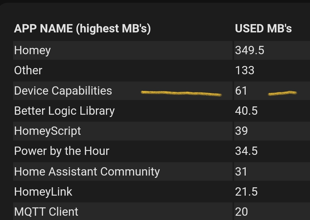

Btw, does anyone found the root cause for too high memory utilisation of the DC app ? It’s crashing quite often for me due to the memory limit (~120MB)
Overhere, it clearly depends on the number of AVDs;
I use app v2.14.9 btw
@ Pro 2019, an app shouldn’t use over 40MB’s
Homey1, crammed with AVDs:
(I think 61MB is somewhat similar to 120MB on a Pro 2023)
Homey2, not many AVDs:
Thank you Peter, this is still quite nice value,but in my case…
I have around… 10 devices?
@Arie_J_Godschalk , any thoughts on that please, is there anything I can do on my side ?
Yea, 10 AVDs is not that much.
My 2nd Homey has 7 of them.
Thanks Peter!

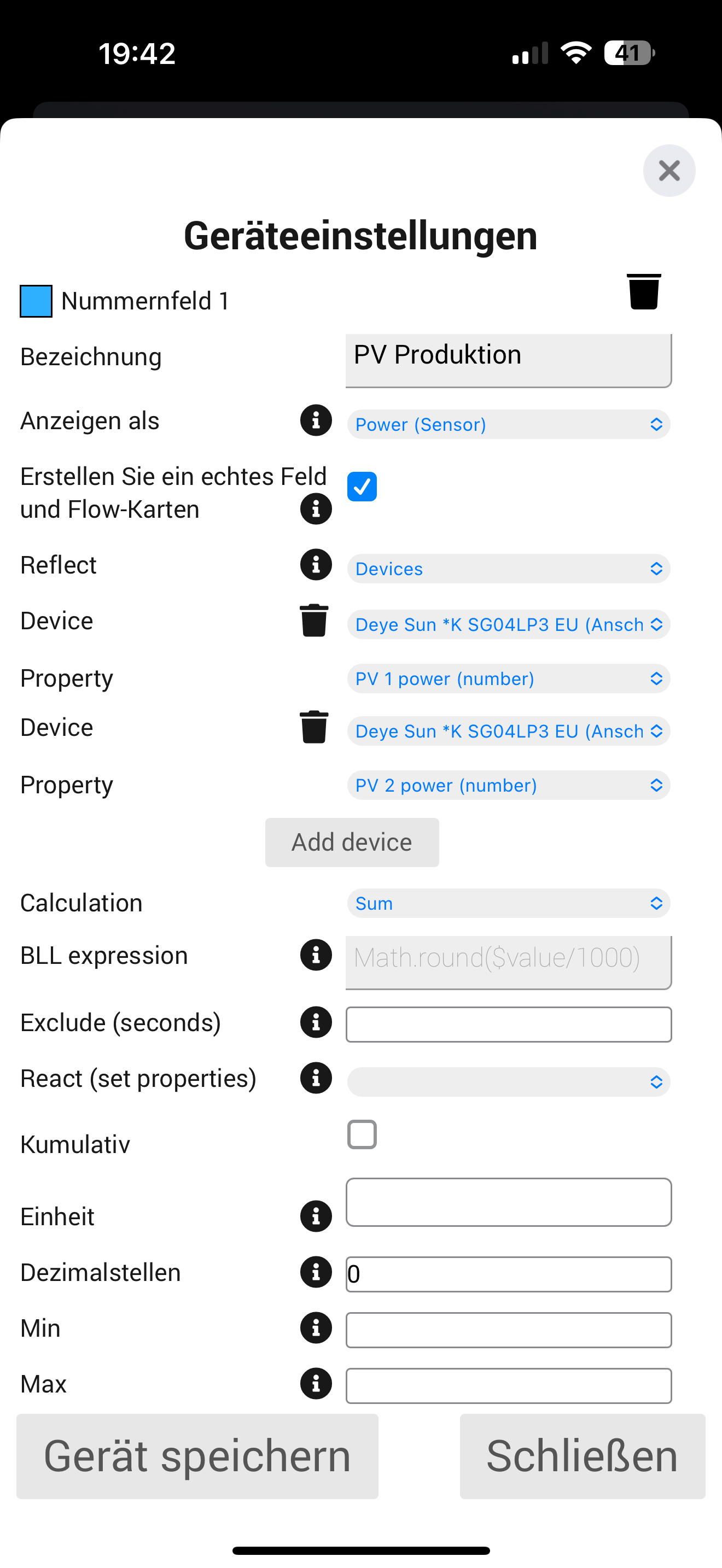

Its working with an AVD.
Device Class: Solarpanel
Add:
Numberfield as Powersensor for PV Produktion
second Numberfield as Energy Sensor for Daily PV Produktion
Then it’s working.

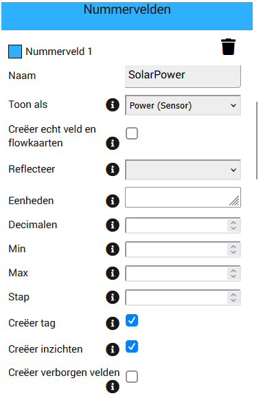

I did. As you can see in the picture the Energy visualisation recoginzes the Solarpanel device class but the values remain empty even though “Solar Power” is a Power (sensor) and “Solar Energy” is a Energy (sensor) in the right picture. Do I need to set more settings in de AVD?
Yes Like this:
Yes, that did it! Thanks so much. I was also able to add my EV charger as a regular sensor this way. Would be nice to have acces to the device class “car” and set ElectricCar paramter as stated under EV paragraph on this page Energy | Homey Apps SDK. This way I should be able to also add the car to the energy visualisation.
