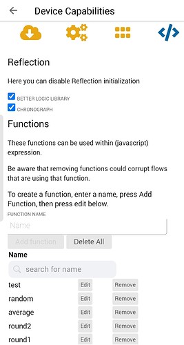

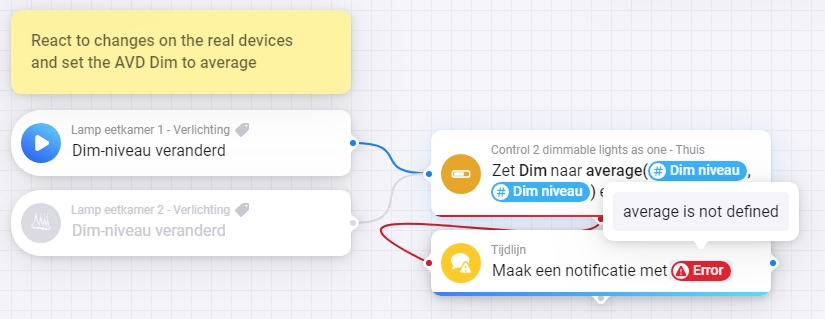

I get an error on control two dimmable lights as on when React to changes on the real devices and set the AVD Dim to average.
Created a new one to test if I had a wrong setting but the new created avd has the same error.
“Average is not defined”
255826b3-b0c4-47bf-a760-c26cf9af7b07
Thanks.
I guess you didn’t create the function “average” yet?

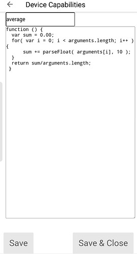

I did that the first time I created one. I checked and for some reason the name was renamed from English to Dutch.
I created a new one with the name average and now it is working again.
Thanks.

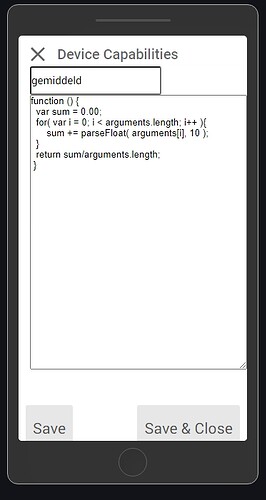

Ah I see! The function name should not be renamed by itself though.
The other day I switched several times from EN - NL - FR - EN, but my function names were not renamed/translated :hugs:
So not sure if it’s app related…
What could’ve happened is when Homey is set to EN and your web app was translated by the browser to Dutch.
That can result in unwanted translations (when you hit save after edit).
It has been a while since I created my first avd so not sure what I have done back than? :man_shrugging:
It has been solved now.

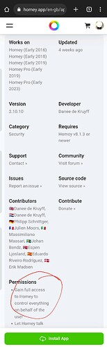

Question/Request : Can this PLEASE :pray: all be done with/by this app without "GRANTING FULL ACCESS/CONTROL of the whole Homey (Pro). Its a matter of privacy / security (& peace of mind for some users.) . Also people which use any kinds of security app/alarm app like e.g. “Woonveilig/HeimDall/ Yale Doorman” etc. could be seen as negligent when somebody breaks in their house and their security system is connected to a insecure device granting full access to their (smart) home to unknown sources/people. A dream come true for every insurance company (not Having to pay any insurance claim).
Please Don’t take this personal. NOT AT ALL. I am suspicious/cautions in general. :sunglasses:

All apps using HomeyAPI need full access as they can acess other apps devices, flows etc.

  • standard apps can only access their own devices and flows => no special rights are needed
  • apps using other apps devices or system settings, logic variables etc. are using HomeyAPI and that needs special rights (full access).
    Developers can’t define other permissions like “access app xxx” or “access logic”. It’s all or nothing.
Trust these apps /developers or don’t use them :wink:
