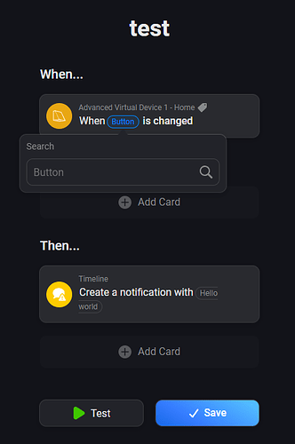

Sorry i’m going to ask a very dumb dumb questions
I wanted to use this app as a nice customisable pushbutton
If “device cap” button is pushed, Then do “something”
But i cant figure out how
In this screen there is systematically no “button” available
And in this on i just seem to not be able to find which function would be best for a pushbutton
Thanks for the help!
Did you add a Button on the Device?
Goto Device Repair to add buttons. :slight_smile:
OHHH thats nice!! thanks!

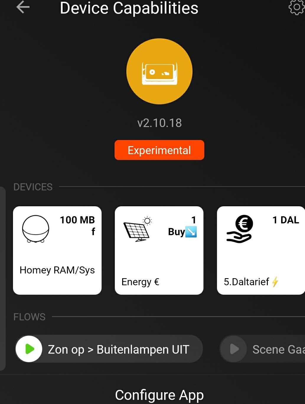

What do you mean by this @Eric_Richters .
Do you mean that when you have a flow with DC-flowcards in it, when you goto the Homey Mobile App and goto the App, it doesn’t show the flow listed there?
You are right, and thanks for reporting it!
A while ago, users asked to save resources, so there are some things not loaded by default.
For some flowcards, that data is needed tho.
I have rechecked all flowcards to make sure loading is executed when needed when using cards.
I will update the test asap, first fix another reported hp2023 bug.
Thanks for the hard work. I am looking forward to the new version.
Answer to your question above is yes. You’ve interpreted the issue correctly:
I do mean that when you have an advanced flow with DC-flowcards in it, when you goto the Homey Mobile App and goto the App, it doesn’t show the flow listed there.
Advanced flow with DC cards are not listed there. Regular flows with DC cards in it do show.
You mean the flow listing on this screen I guess, but it doesn’t show Adv.flows with any app, so it’s not a specific DC app issue imho
Indeed @Eric_Richters , if this is what you mend, this is not yet implemented by Homey/Athom.
(And outside of what we app developers can program).
