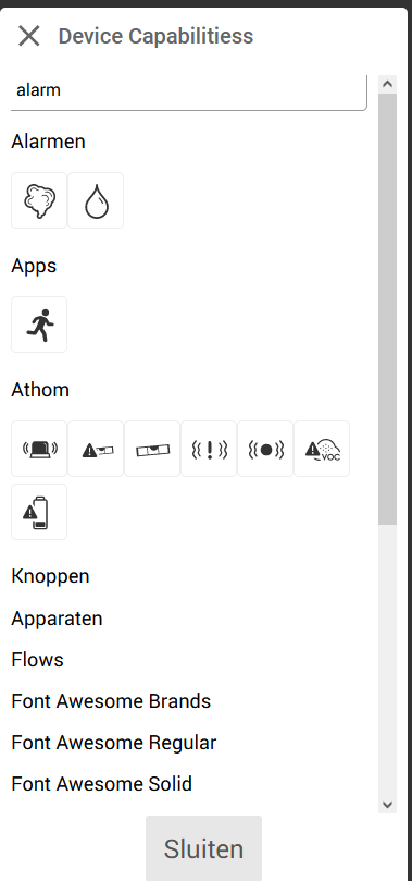

It’s live: Filter the currently 2343 default icons.
Also, increased the loading speed of icons to 100 per second (there is a system making sure all icons are not loaded at once, overloading Homey and getting all non-image-error).
The speed was 50 per second.
To see and filter all icons, you need to wait till al are done loading (well, if you want to see it).
Also added a debounce on the filter fields (so the don’t crash your phone or browser when typing lastly a long word).
Nice to now find more icons than before i could filter:

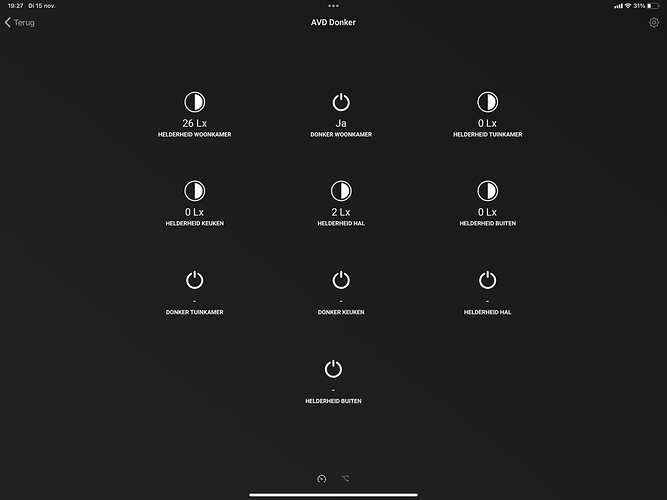

I have created a device with 5 virtual luminance-sensors and 5 virtual onoff buttons. Each pair represents the luminance in a room and a switch for the lights in that room. I would like to order them nicely on a grid pair by pair. Instead they seem to appear in random order or the order they were creat3d on the tab (see image) Is there any way to order them nicely the way I prefer?
Greetingd]s,
Paul
(Currently, not really, only sort them by (re)creating the fields in the right order by changing all icons for instance at once and pressing save)
Well, everytime a field changes certain properties, it is removed and a new one is created: That one will be the last one.
I have been thinking about sorting orders, just like i do with the first button. But it’s a heavy implementation: change field order # 1, and all sequential fields must be removed and recreated: this is really heavy for your Homey!
I am still trying to think of a better solution before implementing it like this.
And placing them in a specific pattern, like side by side: that’s not something a app developer can setup: we only create device fields: Homey creates the UI.
Ok, I understand. Probably I will (re)create the fields in the order I want and in triplets.
Given the choice I prefer that you keep the app as lean as possible as at the moment my Homey feels the load already. But the app is very useful!

Best way: create them in the order that you want.
If you ever need to change field 1 or 2 etc, change ALL (higher numbers at least) icons and press save.
They will al be (re)created in the numbered order.
