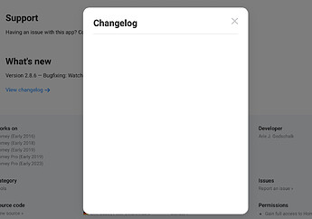

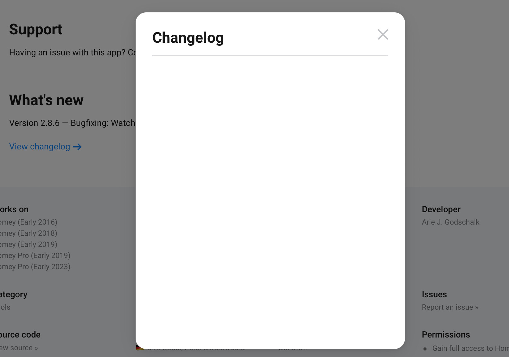

Hi @Arie_J_Godschalk,
the changelog of the Device Capabilities app in the app store is empty:
Just for info.
Yeah i know, been like that for a while.
Must have removed a number from the changelog, and then this happens.
I just don’t know how to fix it.
What, there’s something you don’t know? :wink:
Haha, yeah, there is so much i don’t know, but i am eager to learn :wink:
Turn it around: you’ve found a way to hide the changelog :blush: :grinning:
