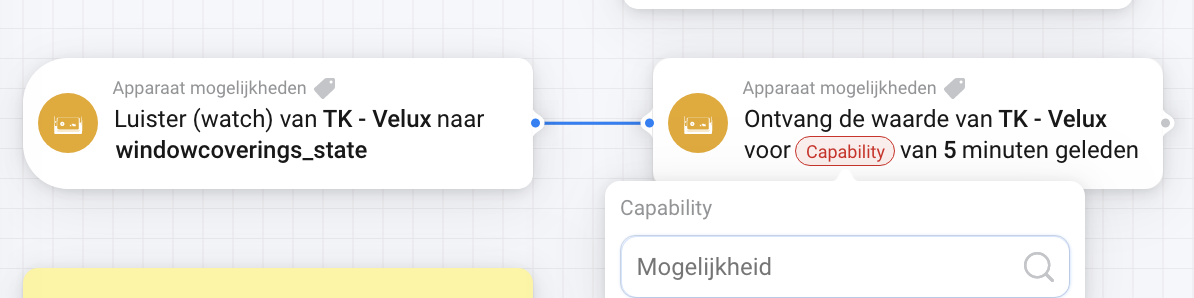

Still a little puzzled::
Do I need the IF card?
And, the THEN card has the ‘capability’ tag, but it does not show any tags, and if I paste the name myself (in this case “windowcoverings_state”)it remains empty.
What are you trying to achive?
You can only recieve values for which there are insights available. Are there for the windowcovering_state for the Tk - Velux?
If it starts to rain, I want the Velux windows to close to 35 % (Regenstand) if it is open AND it is more open than 35%. After the rain, I want the Velux to return to the state it was prior to the rain.
I have made this work, via variabless. These store the state befor the rain starts, and restores this state after the rain. However, your App seems to be able to do this without the variables.
PS
I checked the Insights and no data is available for Velux.
Bummer…
I will stick to my current solution.
Thanks!
I will adjust descriptions so it is more clear it reads data from insights.
Perhaps i can add the functionality for non-insights later on, if so, i’ll let you know.

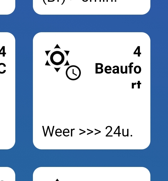

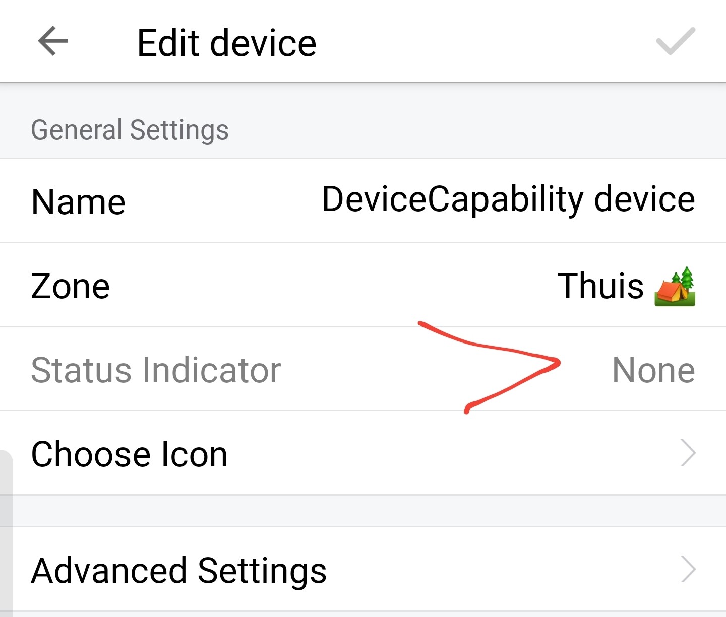

Longshot, but is it possible to pick a text value as ‘Status indicator’ for mobile app and homeydash-like tiles?
I know it can show “x Beaufort” for instance.
Work in progress!
