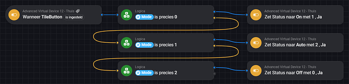

First create a device with a status field, and set button one with the ‘Pushbutton and separate Indicator’ option:
When you press the tile in the mobile app, this flow ‘rotates’ the mode from off to on to auto
By listening to changes to the status capability you can light up of dim the tile with his flow
The same (istening to status changes) can be used to do stuff when the status changes to on (mode is 1) or auto (mode = 2).
This is just a very simple example. My flows for handling my ventilation system are way more advanced (taking toilet use and bathroom humidity into account) but the tile itself only handles the manual mode, rotating the speed of the fan.
Hope this helpes
