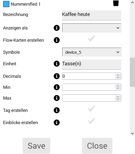

Yeah, already added it into some devices :grin: the new interface really makes it easy, even on mobile.
Unfortunately it also overwrites the icons of those capabilities :thinking:, low key finding that annoying.
You mean the icon gets overwritten (what i have had today one time with a device icon, dont now why), or you mean with default alarm/sensors you cannot set a custom icon?
Indeed, it uses the default capabilities’ icon, not the custom one.
Yeah, sorry about that, have not found a solution to that :wink:
I see you already changed for that behaviour in the latest update by auto hiding the icon input :yum:.
Does free up for some more custom icons I guess.

In Test: Show As Lists are order. by special index and then by name (some will stay at the top or top few). We can later translationobjects in it, and then order by language. The once’s that must stay at top, will.
Not really looking good in a Tab , very small.
Iphone S5 looks good, but scrolling is a bit irritating.
You can just pick a random Icon that’s already in use for something else :yum:.
