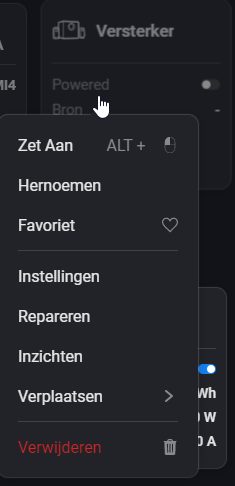

Also, if there a way to trigger/open the repair option from the desktop/webapp? The repair options isn’t available there, so device setting can only be change from within the mobile app.

Richt click on the Device → Repair
Should work now, it is with my mobiles and devices i test with.

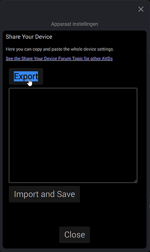

I can press export all I want, but te list remains empty with one of my devices. Others (also older ones) do get the json export.
It’s a very simple device, only three buttons an a textfield, so I’ll recreate it and use the script to repair my flows.
