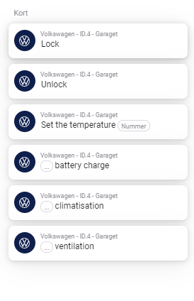

I have restarted the app and alsp tried restarting homey and this is what I get when trying to include a then card in an advance flow. Anyting more I can do to find the cause?
@Tomas_Woren yes, restart the app and send me a diagnostic report after a minute :smiley:
@Tomas_Woren so it seems like sometimes i forget what i build: :joy:
But currently theres not option to set the max charge level
That is only available for Non ID cars
VW is working on a new API so once thats available i’ll revisit all models and implement any new features
