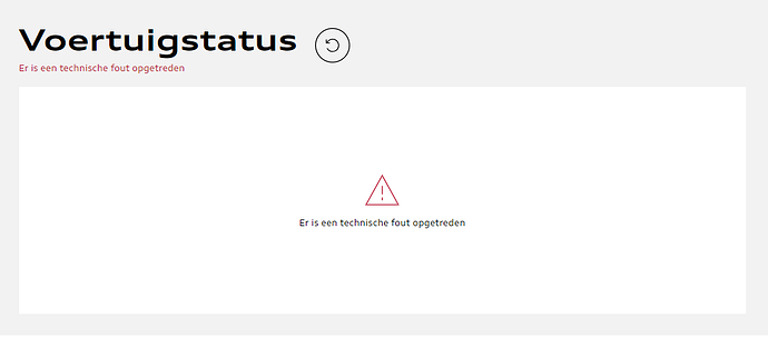

The myAudi app does not work at all for days now (“unknown error”) and while yesterday my Audi responded to the Homey app now it doesn’t anymore
Can’t even login to the my.audi.com website
@zakraket if the ofifcial app and the site cant log you in then it’s definetely an Audi problem… :confused:
This is btw a really good tip, did that too myself:
Already had my updates on 2 minutes so that shouldn’t be the problem here if that works for @Bug
The audi site can’t connect to my car either a.t.m. so that’s surely an Audi issue
Also the configurationassistant on the site (linking your ID and car) hangs on the second step (has been there for at least a year). This all works so badly :frowning:
