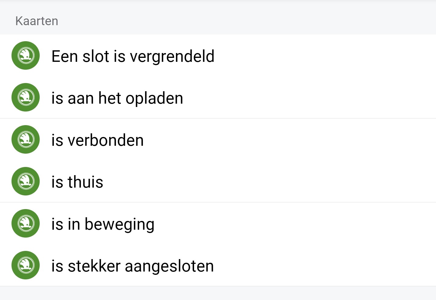

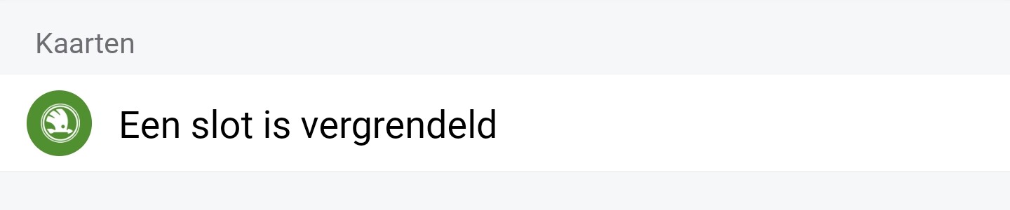

I own a Skoda Octavia Hybrid and added it to the Homey by choosing a Skoda - Hybrid device.
When i make a flow, i only can choose in the “and” field the next option:
When i add the same car as an Skoda - Electric device, i will get more options:
Now i have to add the car twice to homey, one as hybrid and one as electric to make some flows work.
Is it possible to make the “and” options in the flows simulair?
Thanks in advance!

Hmm thats not correct. The Hybrid is the car with the most flowcards.
Can you restart the app and send me a diagnostic report after that?
Thanks for the quick respond,
This is the ID of the diagnostic report:
b1aa1c71-7514-4489-a19a-f304d305b638
No changes after te app restart btw.
I do see an issue. Will try to reproduce and fix today :slight_smile:

Hi @martijnpoppen
I’ve installed the beta app and re-added my car.
In a flow in the “and” field, I’ve still got only one option. (car is locked).
Am I doing something wrong?
Thanks in advance!
@Martin_1985 strange
I tried to reproduce with a VW Hybrid but that worked.
Are you willing to temporarily share your credentials with me so i can reproduce and check what goes wrong?
