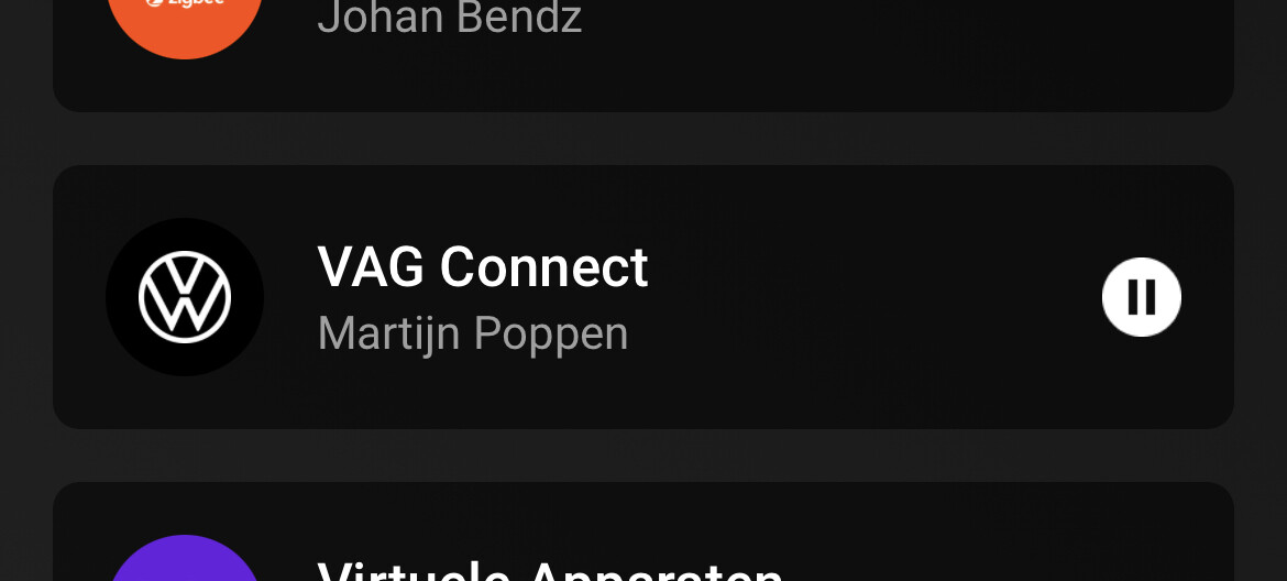

Here is my log.
256b7dfb-4b65-40d3-876b-ba9b70528c84
When I press the red triangle it shows:
Looks like the app is on Pause
Hope this helps.
Regards,
Harry
