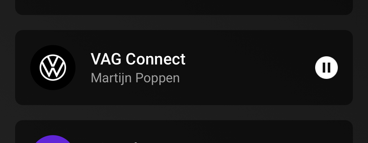

Can you click the red rectangle on the app view?
More - apps - vag connect
Uploading: B778A75D-BF67-4679-8EBA-F683274F0CBA.jpeg…
It says device not available.
Hmm seems like memory issue.
I Will monitor on my side :slight_smile:
