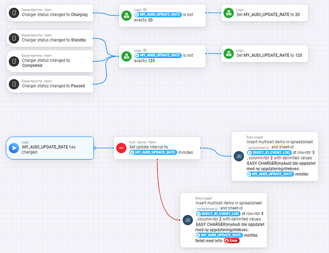

But when the updateinterval is on 60 minutes, Homey can’t detect plugging the connector (right?) so the car will keep charging (when I don’t want it to) untill the update is done, that could be 60 minutes in worst case.
How do you fire a refresh when you connect your car?
@zakraket I use Easee charger and that has a Homey App, so I respond to the change of status from StandBy to Charging
Here’s my flow :
