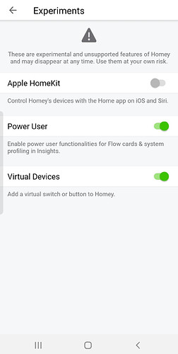

@Tarecco can you do the following:
enable debug in the device settings. and then try the buttons again, send a new report after that
@martijnpoppen you mean that option? power user?
@Tarecco that’s not your Cupra device right? :sweat_smile:
i thought homey one, sorry my mistake, my cupra debug is already enabled.
