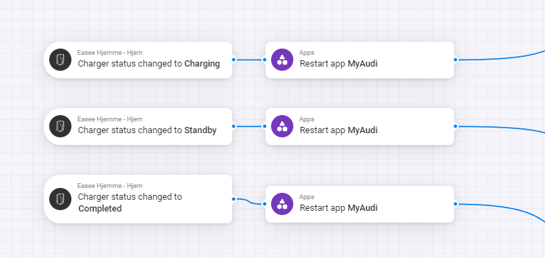

@bwa trying to reproduce your updates.
Do you have your flow like this?
yes, a flow like that

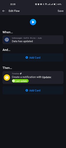

@bwa i do see a double flow trigger. But thats a misconfiguration on my side.
Will check the timing though
Did you set the 3 hours via a flow?
Looks good. Except the double trigger. But that is not a call to the server
Have not set the refresh rate with flows yet. Good to know this is just noise.
Currently I’m only doing this. Having refresh rate to 3 hours, and only getting new refreshed data (with restarting myAudi homey app) when it’s important for my charging. Very slowly reducing the update rate to possible discover the rate limit on API

Cant find a "car is home " card in the audi ev app for a etron. How can i get this info to use in a flow?
Can i somhow use the "Data has updated " And a logic statement for location url?
Any suggestions for flow?
