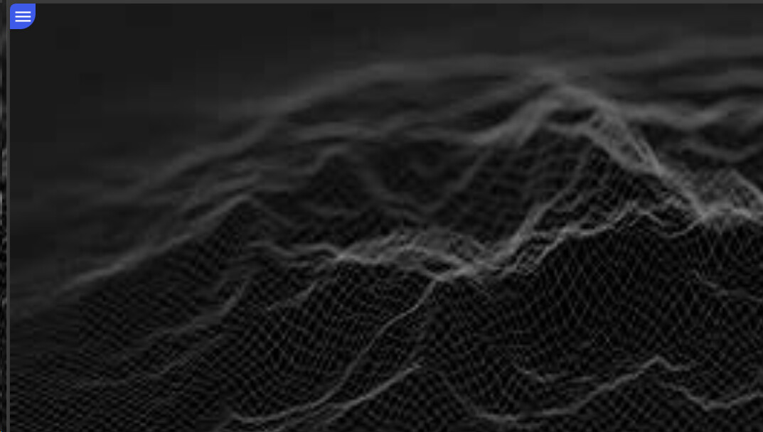

My dashboard now looks like this :wink: and I’m not able to do anything (menu on the topleft doesn’t respond). The same on my phone, Chrome and Edge
@skogsaas
Sorry for nagging about the same thing :frowning: but I really want to understand if it’s a local “problem” or a general problem.

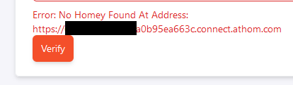

Thanks, but it doesn’t work:
