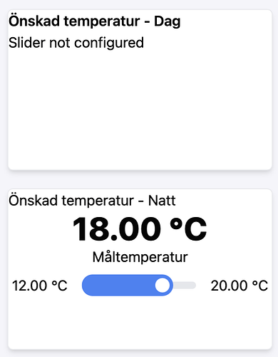

I have an old slider that works but now I can’t add a new one, I only get “Slider not configured”. This virtual device actually had a slider before but I removed it some time ago, now I can’t add it back.
