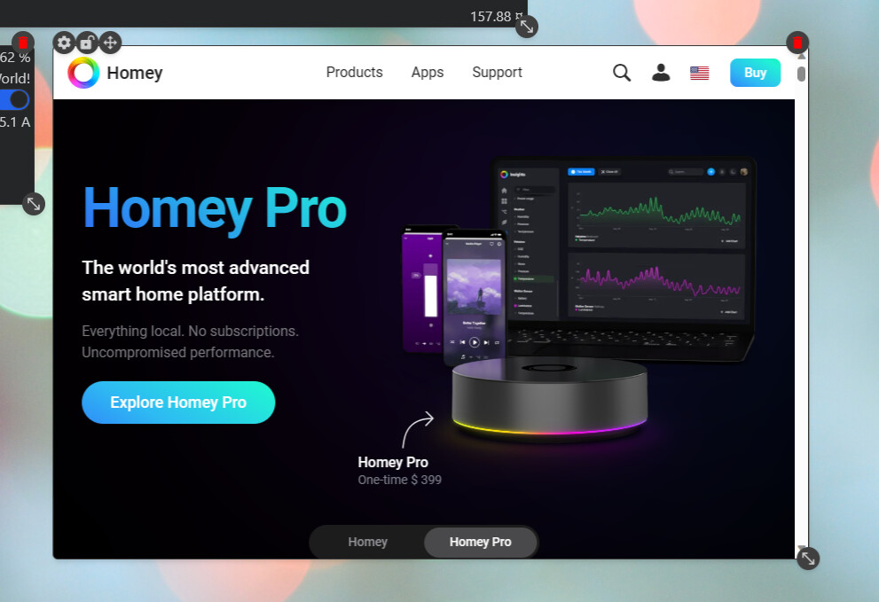

Update 0.14.0 - Iframe widget, logging out and boolean insights
Hi all
I know a lot of you have requested this, so here it is: iframe widget!
It allows you to embed anything, as long as the content allows it :wink:
By default, the iframe is completely sandboxed and dont allow anything. So you have to play with the settings to make everything work based on your needs.
On the bottom of the main menu, you can now click the sign-out button to sign out. This will NOT delete local dashboards that are saved in the browser localstorage.
Boolean insights has also received some love. They now display a stepped graph for on and off. The resolution has no effect for boolean insights, only the last 50 or 100 events are saved by Homey Insights. This is actually used internally in Homey to display historic capability events. I’m not sure if boolean insights should be available as a graph in the future, but for now, this is what you get :wink:
