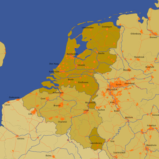

The Buienradar URL errors, but a German rain radar URL works as Homey virtual cam (thanks @RonnyW !)
I don’t get yet why the Buienradar URL doesn’t work in a virtual cam (also doesn’t work with a advanced virtual device virtual cam)
It’s a start!
The Homey virtual cam:
Sad
And this one
https://gadgets.buienradar.nl/gadget/zoommap/?lat=52.155&lng=5.3875&overname=2&zoom=6&naam=Amersfoort&size=2&voor=1

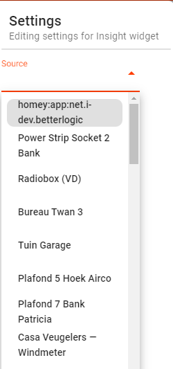

Is it something in my settings? But finding a device in the insights is really difficult. Do I need to change something for the Insight devices to be sorted alphabetically?

Yes, it’s not sorted at the moment. Should be fixed in the next version :wink:
And I see that you have an unknown insight type homey:app:.... I’ll make a note of that, to present the name of the app instead :muscle:

The problem is many weather widgets are in HTML and not in image or video format.
I use the following URL for dutch rain raidar in a virtual homey cam.
https://weerdata.weerslag.nl/image/1.0/?size=ani-forecast-550x550&type=Freecontent
For different widgets you can check: Gratis radarbeelden op je website? Alle actuele buien, regen, onweerradar beelden.
Thanks, another ‘issue’ solved, Marcus! @skogsaas
I have been fiddling with weerslag, but I couldn’t find a working solution.
Yours works perfectly!
