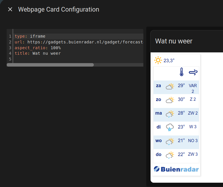

I get it. I wonder how it works, security wise, in HA’s webpage card
