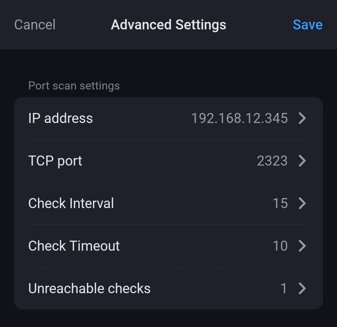

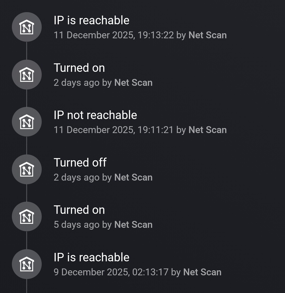

Hello everyone, I can’t get my wall-mounted tablet to work. I installed FullyKiosk Plus on my tablet about two years ago, along with Home Assistant. I switched to Homey and discovered this app that makes everything work. However, I can’t get it to work because it repeatedly disconnects from Homey.Only when I restart the app does it connect, but for a few minutes after that it becomes unreachable again. I should point out that the tablet has a fixed IP address and the network is very stable. I’m definitely doing something wrong with the fullykiosk. Can you help? Thanks.
P.S. I used Google Translate for the translation.
Hello Andrea,
Nothing personal, really, but I’ve learned to never believe this as a fact:
Homey and a wifi connection can be flaky in certain situations.
So,
  1. Which Homey model?
  2. If 2023/2026: is it wifi connected?
  3. You can check the network connection for real with a NetScan app TCP Port device.
    Example:
    Log:
You can create a notification flow as well.
Hi Peter. I have a Homey Pro 2023 connected to Wi-Fi and LAN with its adapter. I installed Net Scan and am now waiting for the results.
