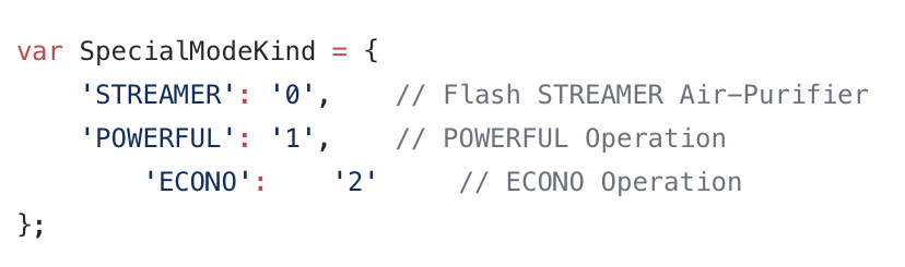

“Ventilatie-functie” you mean the “Streamer” functionality? It should work based on the documentation I use. If this is your only incentive to buy a Homey I suggest that you keep your money in your pocket ;-), see software disclaimer.

The streamer function is a function that uses a plasma-burner to kill bacteria etc.
Forgot to mention: Thanks for all the work you have put into this wonderful app!
Checked my documentation ones again, it does not mention a “Ventilation” mode.
Would it be the unmentioned number 5?
Ventilation/fresh is only functional in the Ururu-model.
It might be, however the problem with the Daikin interface is hidden in this remark I make in the ‘description’ of my app…
Not all Daikin airconditioner models / model series / combinations of indoor and outdoor units are supported. Due to the fact that Daikin does not disclose their interface specification reverse engineering of the interface is extremely difficult.

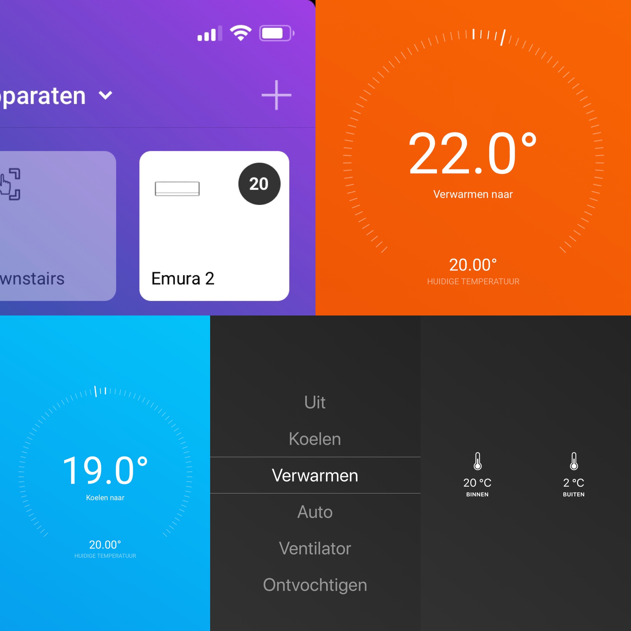

If all goes according to plan Daikin AI for Homey v2 will be available for all Homey v2 users as beta in the second half of next week, a few screenshots of the new app you’ll find below.
Still work todo… there are some cosmetic issues that cannot be fixed at this moment, fan speed and swing direction control are not yet available due to a firmware short coming.
