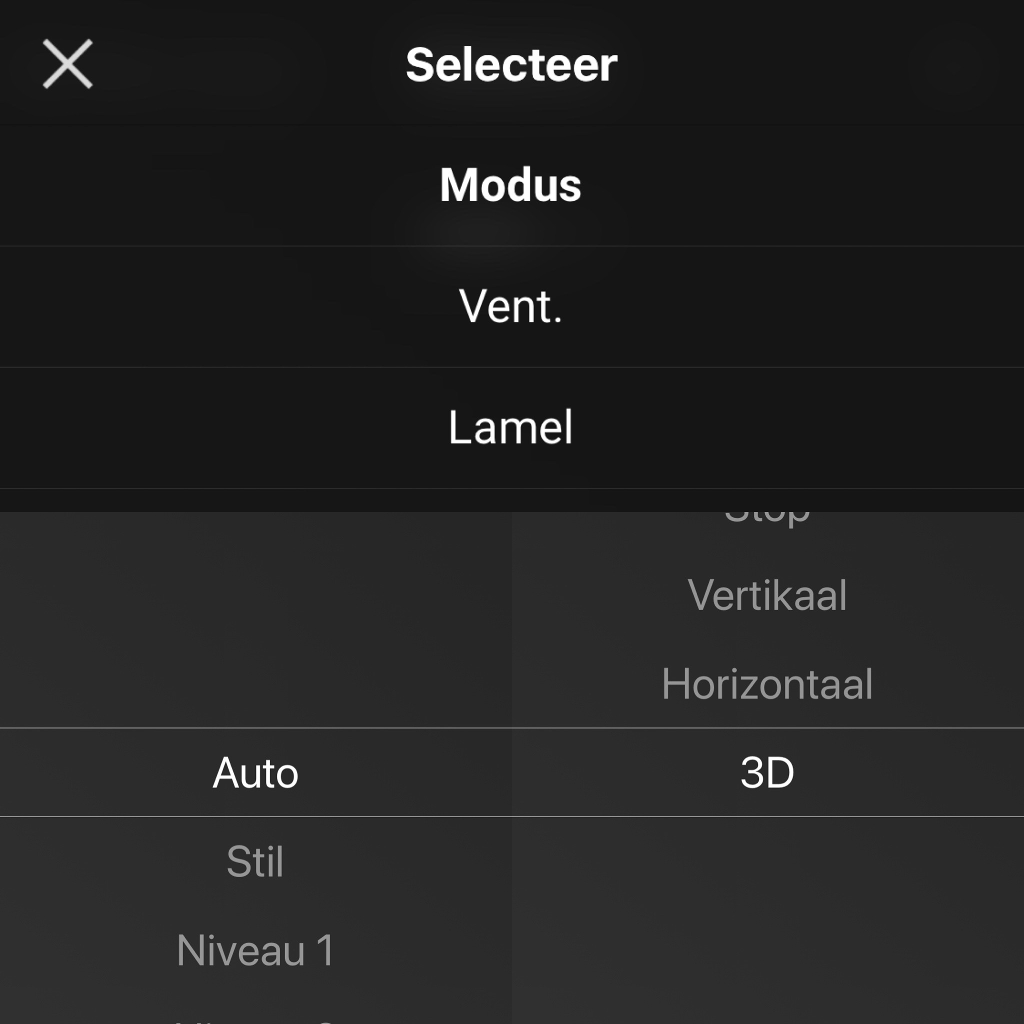

@Sjalabert when you install the latetst testflight version of the Homey app you can control swing and fan again.
Yes!!! Great!!!
The text within in the yellow circle is too long and I will correct this in a future update, see screenshots.
Version 2.0.8, with the above shown cosmetic fixes, will be available via the app store later this week. Initially as beta a couple of days later as stable release. Note: that the above shown functionality requires Homey’s mobile app version 2.0.6 or higher.

What has changed? The AC function naming for the “picker” selections.
Note: the “Airflow Rate” and “Swing” (a picker) control requires Homey mobile app version 2.0.6 (for iOS, Android app version number ??) or higher to be shown, see also the screenshots in above posts.

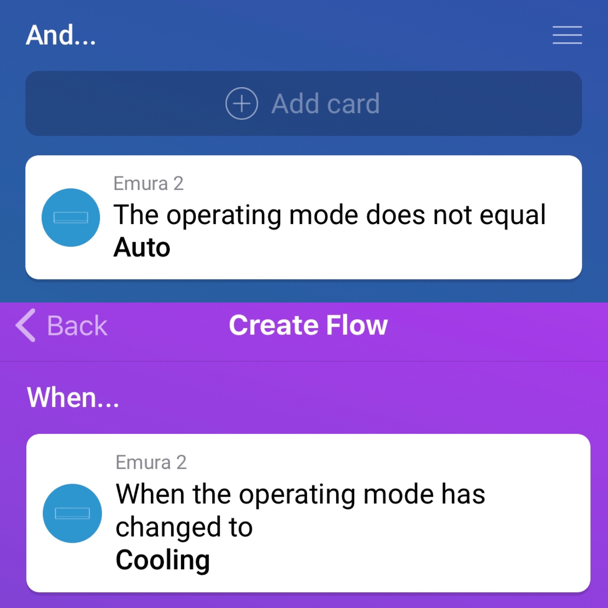

Announcement: In a upcoming release it will be possible to add a trigger / condition card based on the airconditioner its operating mode.
Version 2.0.10 will be available as beta later this week.
Version 2.0.10 is now available in the App store as beta version.
Version 2.0.10 is now available on the stable channel via the App Store.

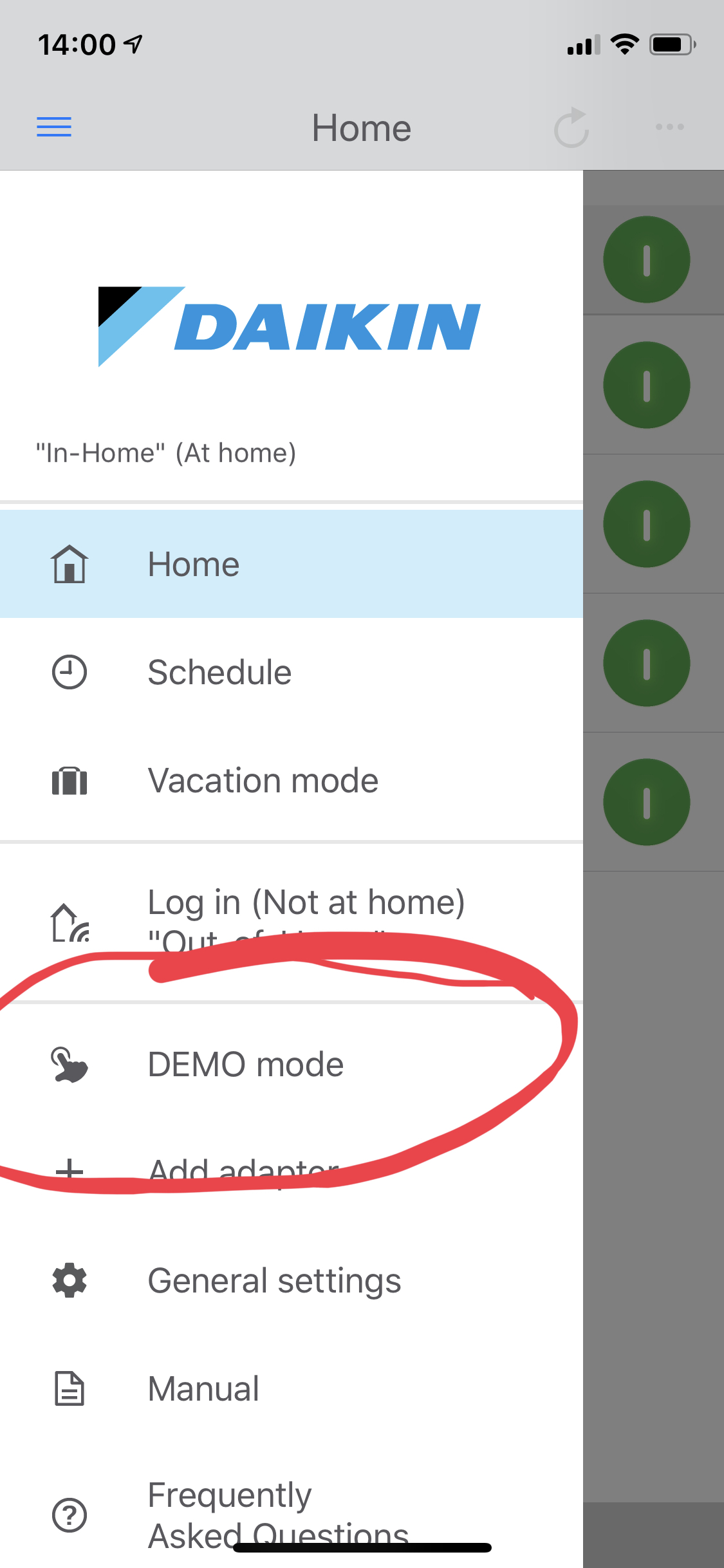

I’ve then configured 4 a/c controllers through their static ip addresses … pretty happy with the results! All but one thing is working seamlessly with homey, HomeKit etc. the only thing that hasn’t been working is the “turn on” feature neither through Apple home kit not in the homey app. The App will show as “on” for a few seconds but then return to off. The actual aircon /heater won’t change state and stays off.

The wifi adapter is BRP072A42 I’ve used the template for comfort as Wells’s HomeKit … both has the same issue on any of the a/c units

@RZLO hi, check your advanced device settings… demo mode should be set to NO.

thanks for the quick response. what leads you to think that it’s on demo mode? (i.e. which flag from the get output?)
the settings seem to be different here - the demo mode isn’t located under each device, but rather it’s a global setting on the app menu. see attached screenshots.
that could be a difference in the app version or even on the adapter model (yours is BRP069A and mine is BRP072A42). also, the device is fully operational (if it was in demo, it wouldn’t respond to changes, right?)

I am talking about Demo mode in the Homey Daikin AI app… you are sending screenshots of another app (Daikin’s own app).
