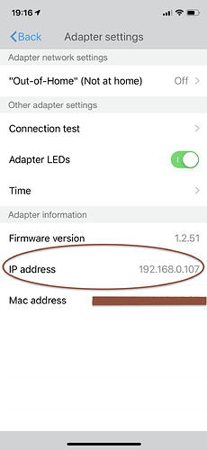

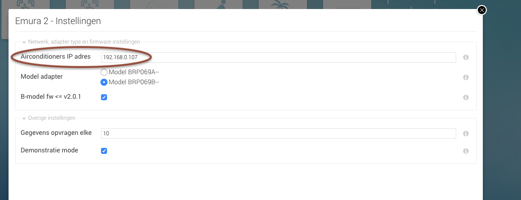

I have installed this adapter into my own Emura 2 and as expected I am also unable to pair with my Emura 2. However before I tried it to pair I updated my Airconditioners IP address setting with that of the type B adapter (which was assigned a new IP-address through DHCP…) and as expected I have no problem of controlling my Emura 2, so it seems that the issue is limited to pairing.
Advice: after updating your firmware do NOT remove the already paired device when you can not control the airconditioner but first check that the IP address that is used is correct from the settings menu and update that as needed. If it is okay, reboot Homey etc but in no case remove the already paired device (as pairing is broken for now).
