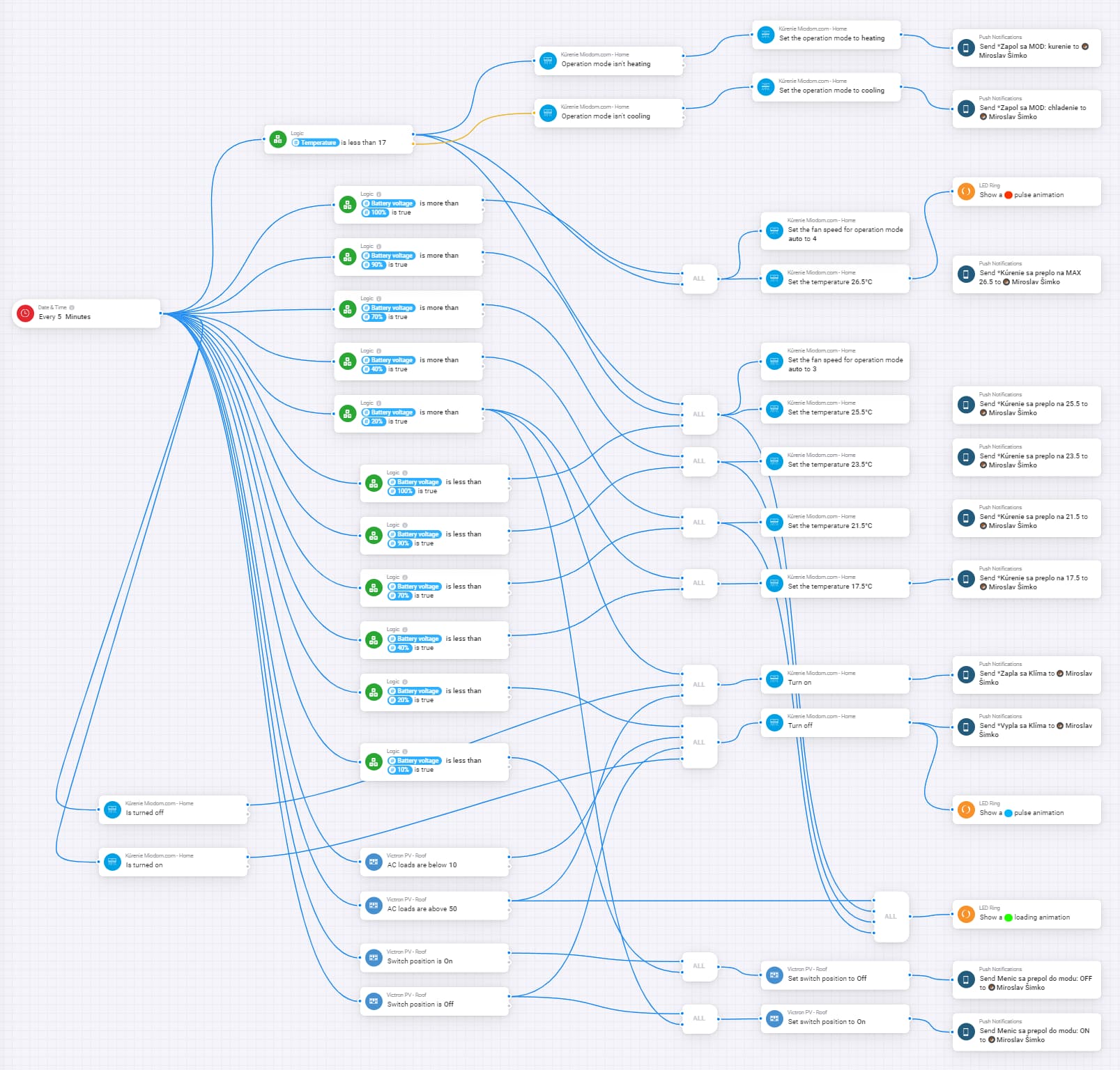

It’s a pity that I can’t control the ECONO mode with this app. In a low-energy house with a Victron solar power plant, it would be a very useful feature for saving energy. Additionally, I am missing the feature to read the current temperature setting of the air conditioning. I have a Daikin Perfera air conditioner. ECONO needs to be turned off when the sun is providing a lot of energy, or when the batteries are fully charged. If the energy decreases, by turning on ECONO I can reduce consumption by half and keep the house warm for a long time.
In the picture I have my heating depending on the sun and SOC of the battery. But I miss the ECONO mode for the perfection of the solution.

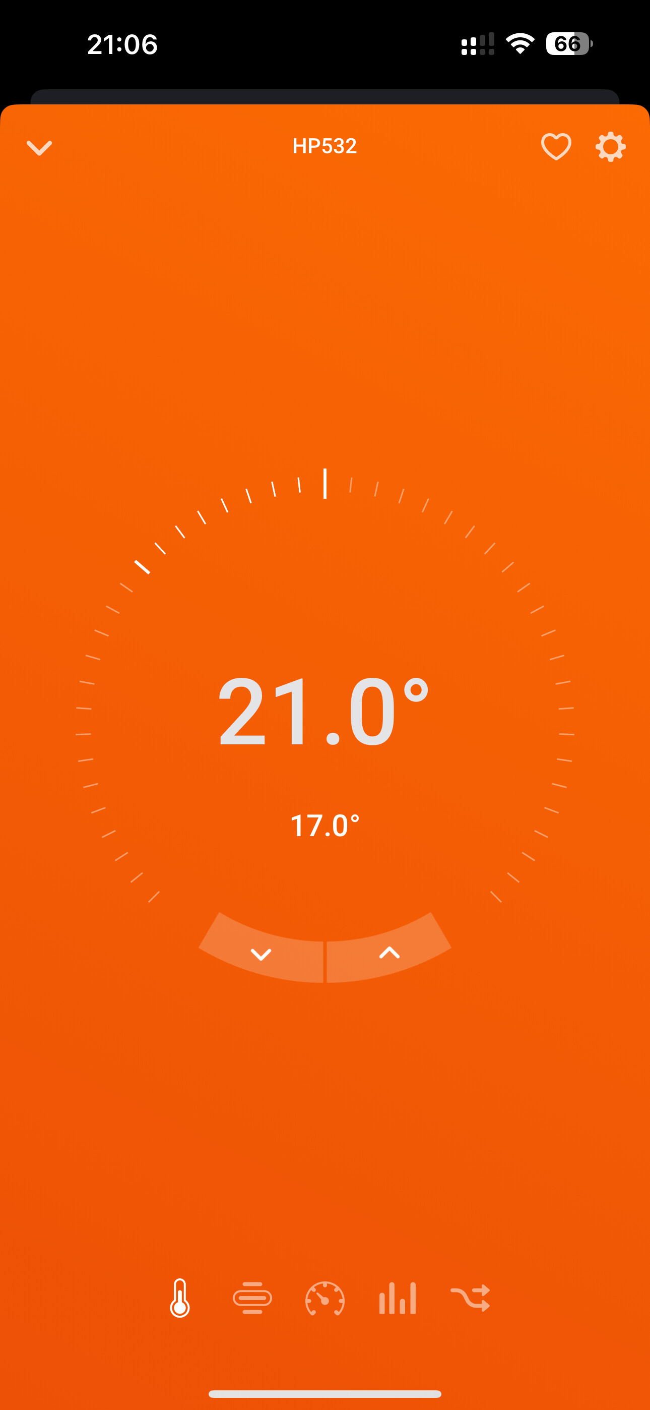

Hi Ruud, the app is already able to increment the temperature in steps of 0.5 degC, see screenshots.

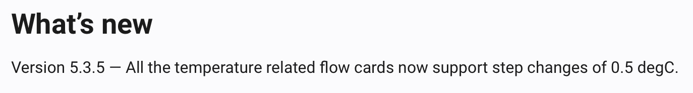

I made changes to the app so that from this specific flow card the target temperature can also be changed in steps of 0.5 degC. A test version (v5.3.4) is available for those interested or using this flow card also.
Version 5.3.5 is now live.
