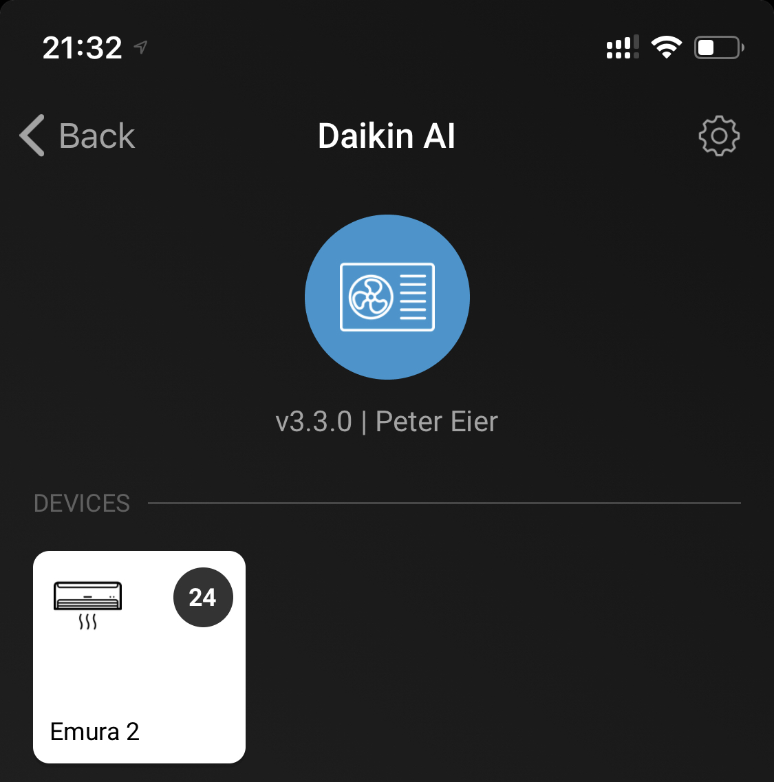

Hi @Jan_Peeters, I replicated your flow and it is working fine with my Emura 2.
App version can be found ‘More’ > ‘Apps’ > look for Daikin Ai.
The version is 3.3.0 indeed.
