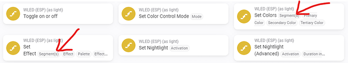

ok, i found it but i cant seems turnning on the lights by segments or im asking something that not supported yet?
No it is there. But segments cannot be controlled by the UI. Because segments are a dynamic thing and the UI is static. What you are looking for are the flowcards to control the segments. Look for these THEN cards for your WLED device:

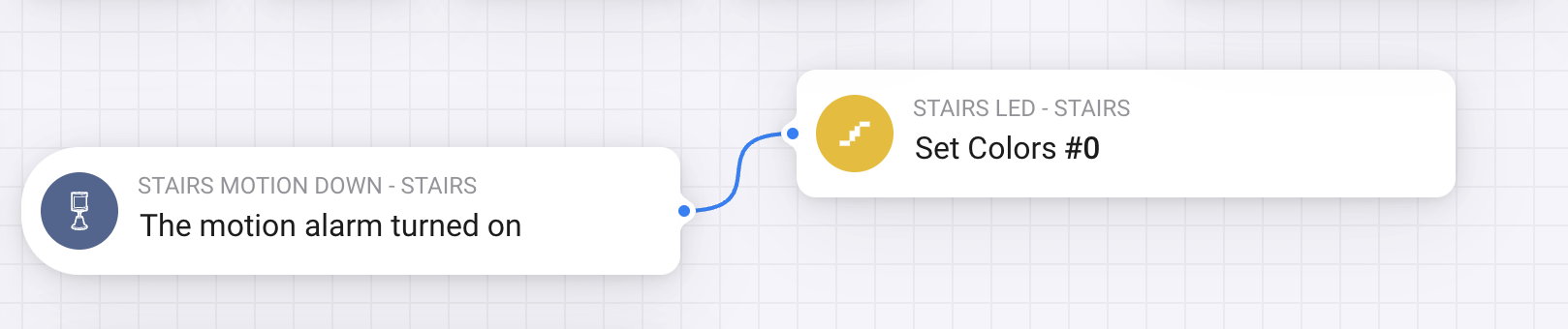

i found those flows, i have created a test flow, color is white. but nothing is happening.
btw thanks for your time.
Looks like something is missing. Is that the segment set card? You might actually need to send a turn on command to the WLED first and not just a color change. It has been a while since I been working with WLED things ^^‘’’
done that, if i add turn on card, all lights will turn on and segment #0 has different color.
Thaaat cannot really be. Please double check and make sure you are targetting the correct segment. I am not sure bot sometimes things start with 0 sometimes at 1. Make sure the LED Profile is set correctly in your WLED and that the segment can be controlled from the WLED app.
If that does not turn out, please reproduce this by executing the flow once and sent an app diagnostics report for this app right afterwards. Can check whether I can see the issue in the logs.

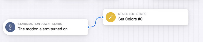

check my flow and my stairs. it seems #0 is correct.
8285bf21-066a-471c-842e-b12ba5a0e8a7
please let me know if you need anything else.
Strange. I cannot see anything going wrong really. Also there are no errors.
I have no idea what could possibly be wrong.
Does setting the whole strip work? If not something else is strange. Incompatible WLED firmware or whatever. But if setting the whole strip works then there is something strange with your segments. I got no idea.
