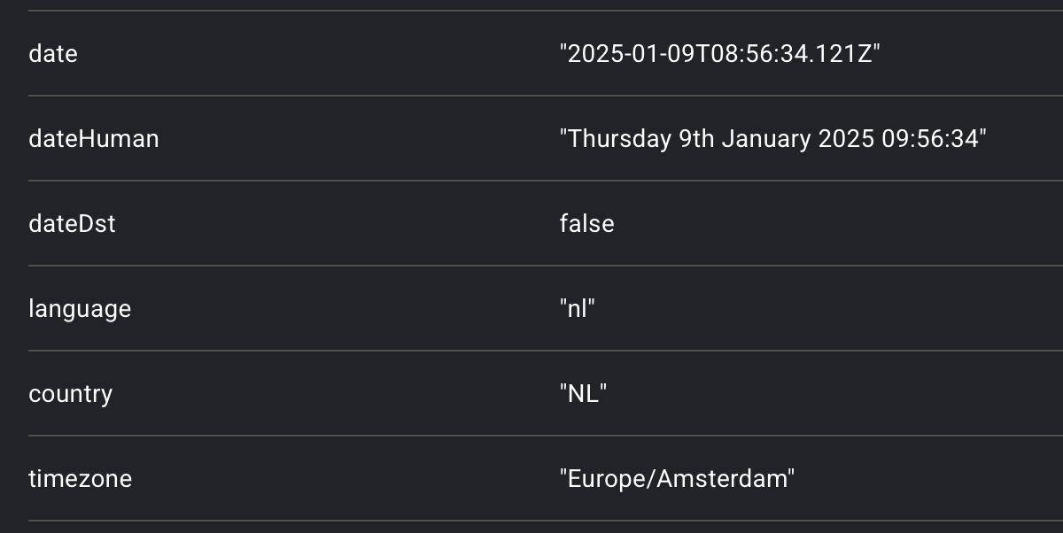

When it’s about the local time, it should.
So, I just tested with Jakarta as well, got the same results :man_shrugging: no change!
Then I set it to Sydney, and that changed the local time like it should:
Can you give it a go using Sydney?
Preferably use https://tools.developer.homey.app/tools/system to view the time.
Hi Peter, this morning I selected Sydney. The time via your link does indeed show the local Sydney time. After that, I installed the SolaX app, both while set to Sydney and back home in the Netherlands. Unfortunately, neither worked successfully.

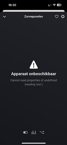

Lately, I have been getting more and more frequent messages: Cannot read properties of undefined (Reading Soc)
sometimes this error stays for half an hour sometimes half a day, each time at a random time.
Now it gives this message from 16:00 today, before that it did give the value. (I didn’t change something or do to it)
On the solax cloud app everything works fine and no error message is shown.
Any idea what I can do about this?
thanks in advance for the help

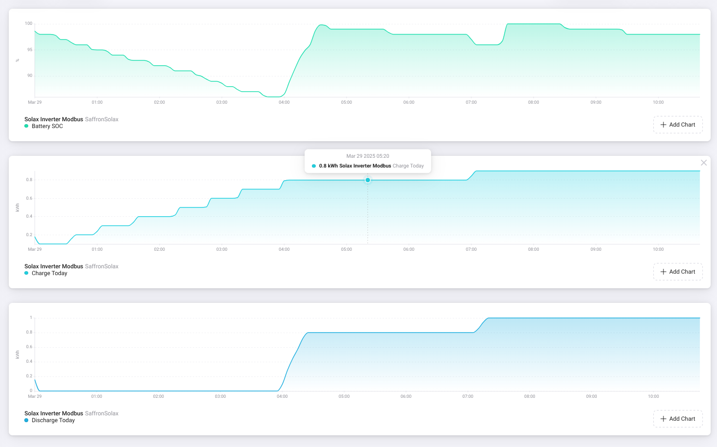

Hi Michal I recently got my Homey and am delighted with the insights that your app is providing. I have been reviewing the different insights available. I have the impression that the labels for “Charge Today” and “Discharge Today” have been swapped. As you can see from the attached screenshot, when SOC increases (i.e. charging) that is when the “Discharge Today” curve rises. In contrast, when SOC decreases (i.e. discharging) then is when the “Charge Today” curve rises.
Happy to accept that I have misunderstood, and welcome your response. It’s only a cosmetic problem and doesn’t stop me using the data. Fantastic.
