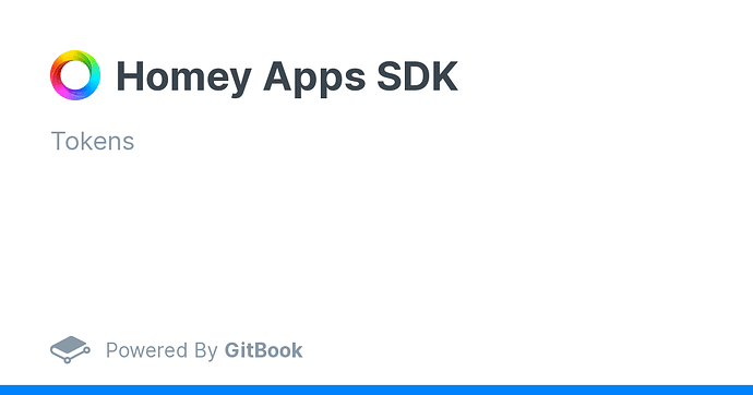

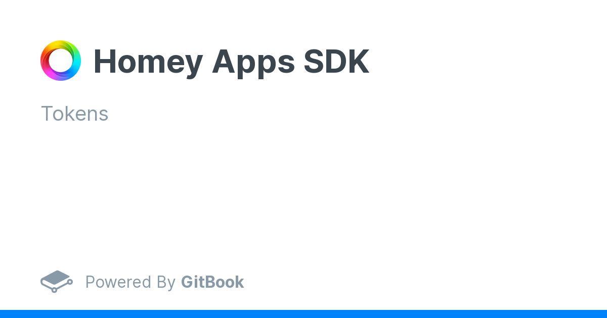

With advanced flows this was recently added, see this developer doc:
But it will have to be new then cards with an additional tag for advanced flows only or it will break all current action cards.
