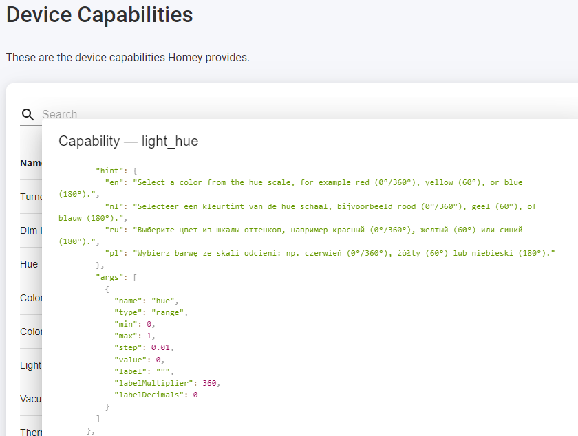

In Homey I have a virtual device with Hue color capabilities that are stored in decimal notation.
Homey uses the following standard for this light capability.
I have a remote touch panel that sends color in Hue 0-360° degrees to my Homey, but I don’t know how to convert this to decimal notation.

No need for complex calculations, just devide by 360 to go to percentage (0.00 - 1.00) that Homey uses, you might need to round it to 2 decimals:
{{ round(VARIABLE / 360, 2) }}
Many thanks Caseda, this work great.

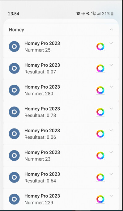

Please see below the flow and calculation I used and their results.
You used the wrong flow card, you need the Calculate as Decimal Number also it doesn’t need {{}} you just could enter #Number 1/360
Please can you tell me witch (then) flow card is the right one? I used ADV.
