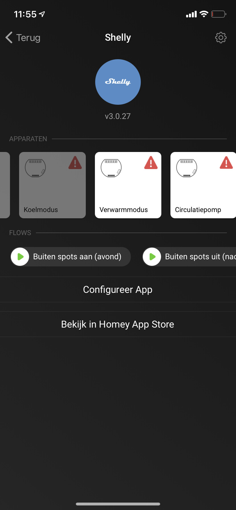

Hi all, I face a lot of problems lately with my Shelly’s. They have fixed IP, latest updates. What’s going on?! IMG_6706.PNG|231x500
@JohnK @Philip_Montgomery
Thanks for the reply’s.
I could change the auto close to 0,75 seconds (never had any problems with that) but that does not solve my problem. The problem was that the button stays on, and i don’t use flows to use the button.
Anybody??
Solved!
After update Shelly to V1.10.0 and Shelly App to V3.0.27 it seems to be working again…
