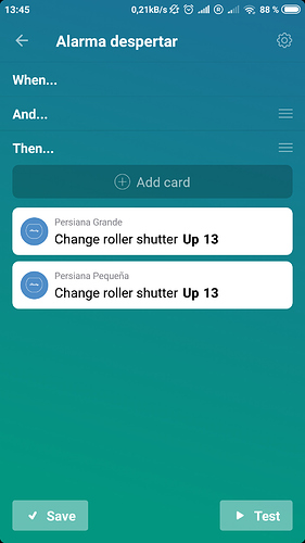

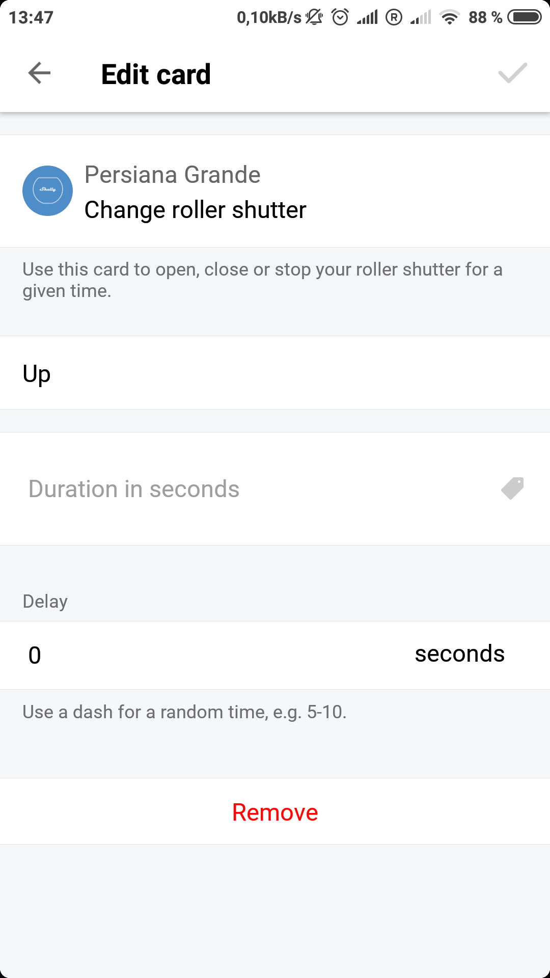

Here the screenshots of flow:
homey homey
Ok, nothing strange in those screenshots. I have pushed another debug release to Github and made a small change in the duration argument. Could you try again?

Ok, at least the new action card with setting the percentage now works. Just to make sure, setting the blinds using duration still does not work and open/closes to 0/100%?
the card of duration in seconds still does not work, opens or closes 100/0%
