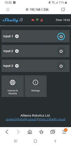

I am using a i3. I dont know how i can use it in a flow when a input is “true” the flow is : when > action event. And device is i3 and? Than
 is it also possible to add the status of the switch in the dashboard?
Thanks for the great app
As far as I can tell the Shelly i3 is unware of the state of the switches connected. It only allows you to filter on the actions it recieves and forwards to Homey using the action event token (which for instance is double_shortpush_2 indicating a double push event on input #2).
Could be I missed something though. Just to be be sure, could you post the output of http://yourshellyi3_ip/settings .
If I’m not mistaken about this a possible solution is adding a virtual switch and track the state of this switch based on the events. I might even be able to do this in the code and add a on/off device for each input come to think of it but it would not be foolproof as the Shelly i3 just can not be sure about the state of the connected switch.
I use it as a door sensor. If the contact is closed, i can see the state on the shelly. So i thought maybe
{“device”:{“type”:“SHIX3-1”,“mac”:“A4CF12F47665”,“hostname”:“shellyix3-A4CF12F47665”,“num_inputs”:3, “num_outputs”:0},“wifi_ap”:{“enabled”:false,“ssid”:“shellyix3-A4CF12F47665”,“key”:""},“wifi_sta”:{“enabled”:true,“ssid”:“Mywifi”,“ipv4_method”:“dhcp”,“ip”:null,“gw”:null,“mask”:null,“dns”:null},“wifi_sta1”:{“enabled”:false,“ssid”:null,“ipv4_method”:“dhcp”,“ip”:null,“gw”:null,“mask”:null,“dns”:null},“mqtt”: {“enable”:false,“server”:“192.168.33.3:1883”,“user”:"",“id”:“shellyix3-A4CF12F47665”,“reconnect_timeout_max”:60.000000,“reconnect_timeout_min”:2.000000,“clean_session”:true,“keep_alive”:60,“max_qos”:0,“retain”:false,“update_period”:30},“coiot”: {“update_period”:15},“sntp”:{“server”:“time.google.com”,“enabled”:true},“login”:{“enabled”:false,“unprotected”:false,“username”:“admin”},“pin_code”:"",“name”:"",“fw”:“20200601-123434/v1.7.0@d7961837”,“factory_reset_from_switch”:true,“discoverable”:true,“build_info”:{“build_id”:“20200601-123434/v1.7.0@d7961837”,“build_timestamp”:“2020-06-01T12:34:34Z”,“build_version”:“1.0”},“cloud”:{“enabled”:false,“connected”:false},“timezone”:“Europe/Amsterdam”,“lat”:52.156700,“lng”:5.384760,“tzautodetect”:true,“tz_utc_offset”:7200,“tz_dst”:true,“tz_dst_auto”:true,“time”:“22:31”,“unixtime”:1591828280,“hwinfo”:{“hw_revision”:“prod-2020-04-21”, “batch_id”:1},“longpush_duration_ms”:{“min”:800, “max”:3000},“multipush_time_between_pushes_ms”:{“max”:500},“inputs”:[{“name”:null,“btn_type”:“toggle”,“btn_reverse”:0,“btn_on_url”:“http://192.168.1.150:80/api/app/cloud.shelly/button_actions/shellyi3/shellyix3-A4CF12F47665/btn_on_1/",“btn_off_url”:“http://192.168.1.150:80/api/app/cloud.shelly/button_actions/shellyi3/shellyix3-A4CF12F47665/btn_off_1/”,“shortpush_url”:null,“longpush_url”:null,“double_shortpush_url”:null,“triple_shortpush_url”:null,“shortpush_longpush_url”:null,“longpush_shortpush_url”:null},{“name”:null,“btn_type”:“momentary”,“btn_reverse”:0,“btn_on_url”:“http://192.168.1.150:80/api/app/cloud.shelly/button_actions/shellyi3/shellyix3-A4CF12F47665/btn_on_2/”,“btn_off_url”:“http://192.168.1.150:80/api/app/cloud.shelly/button_actions/shellyi3/shellyix3-A4CF12F47665/btn_off_2/”,“shortpush_url”:“http://192.168.1.150:80/api/app/cloud.shelly/button_actions/shellyi3/shellyix3-A4CF12F47665/shortpush_2/”,“longpush_url”:“http://192.168.1.150:80/api/app/cloud.shelly/button_actions/shellyi3/shellyix3-A4CF12F47665/longpush_2/”,“double_shortpush_url”:“http://192.168.1.150:80/api/app/cloud.shelly/button_actions/shellyi3/shellyix3-A4CF12F47665/double_shortpush_2/”,“triple_shortpush_url”:“http://192.168.1.150:80/api/app/cloud.shelly/button_actions/shellyi3/shellyix3-A4CF12F47665/triple_shortpush_2/”,“shortpush_longpush_url”:“http://192.168.1.150:80/api/app/cloud.shelly/button_actions/shellyi3/shellyix3-A4CF12F47665/shortpush_longpush_2/”,“longpush_shortpush_url”:“http://192.168.1.150:80/api/app/cloud.shelly/button_actions/shellyi3/shellyix3-A4CF12F47665/longpush_shortpush_2/”},{“name”:null,“btn_type”:“momentary”,“btn_reverse”:0,“btn_on_url”:“http://192.168.1.150:80/api/app/cloud.shelly/button_actions/shellyi3/shellyix3-A4CF12F47665/btn_on_3/”,“btn_off_url”:“http://192.168.1.150:80/api/app/cloud.shelly/button_actions/shellyi3/shellyix3-A4CF12F47665/btn_off_3/”,“shortpush_url”:“http://192.168.1.150:80/api/app/cloud.shelly/button_actions/shellyi3/shellyix3-A4CF12F47665/shortpush_3/”,“longpush_url”:“http://192.168.1.150:80/api/app/cloud.shelly/button_actions/shellyi3/shellyix3-A4CF12F47665/longpush_3/”,“double_shortpush_url”:“http://192.168.1.150:80/api/app/cloud.shelly/button_actions/shellyi3/shellyix3-A4CF12F47665/double_shortpush_3/”,“triple_shortpush_url”:“http://192.168.1.150:80/api/app/cloud.shelly/button_actions/shellyi3/shellyix3-A4CF12F47665/triple_shortpush_3/”,“shortpush_longpush_url”:“http://192.168.1.150:80/api/app/cloud.shelly/button_actions/shellyi3/shellyix3-A4CF12F47665/shortpush_longpush_3/”,“longpush_shortpush_url”:"http://192.168.1.150:80/api/app/cloud.shelly/button_actions/shellyi3/shellyix3-A4CF12F47665/longpush_shortpush_3/”}]}
It’s strange Shelly shows this in their app while this data is not available in their API (also not in the output you posted). There should be an on/off variable (with other Shelly devices it’s called ison) in there for me to work with. So for now there is no way for me to show this data in Homey in a reliable way, Shelly would have to updated their API for this.
I’m interested to know though what kind of contact is connected to input 1 as door sensor?
