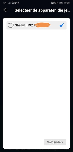

Did somebody already receive a door/window sensor? I just got mine but I cant seem to pair it with my WiFi network. The pairing process is awefull and when I finally seem to be able to pair it ,it tells me something that the device did not accept my connection. Hope to build support for it but I need a working device.
The error in Dutch is “Er is een probleem opgetreden. De app heeft het verzoek om een apparaat te kiezen geannuleerd.”
Quite annoying.
[EDIT] Had to use a different device. My Android 10 device did not work.
