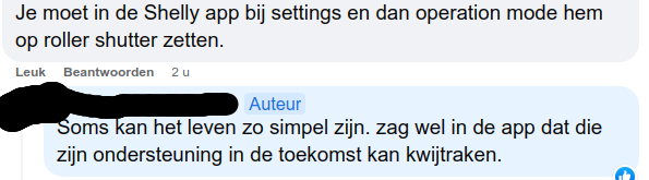

Just a question. see reports that the shelly 2.5 / that type of device may no longer be supported in the future anyone know if support for it will end? can’t find any information about it.

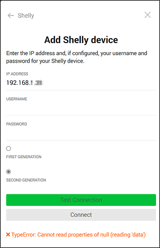

I’m unable to add new devices. I have tried adding 2 door sensor 2’s, but it does not work.
It find’s the device, but after continuing, it just get’s stuck on white “page”. Tried on phone and web app:
After restarting the app in Homey, it does not find the device anymore. I get the option of putting in IP address, but this function does not work either. I only get an error:
What can I do here? Devices have latest firmware.
Report: 1dcda6d6-00e2-42a1-b913-14977d2f317b
Networking errors. Restart Homey, Shelly and possibly your router. This is not an issue with the app. There is a networking troubleshoot guide in the first post.
I restarted Homey and my router. Same issue. After maybe 6 hours total, I have given up. I added the device to Home Assistant, and then added the sensor to Homey through the HA app. It works perfectly. I don’t like to go through HA, but I’ll rather do that than wasting more time
