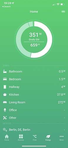

my Shelly EM isn‘t recognized as a Smart Meter with the new driver model. It’s measurement is added on top of the other zones. I‘m on version 3.10.13.

The Shelly (3)EM is added with the cumulative = true setting as described here: Energy - Homey Apps SDK as the device . This is the same as on the old driver although there a device setting did allow to override this. Unfortunately this settings is (currently) not available as it’s not possible to configure this for the generic driver. I already posted a feature request for this in the Homey SDK Github but no response from Athom. Perhaps I can create an action card to toggle this setting but I would have to look into that. Could you request this as a feature on the Shelly app Github so I wont forget. And of course pressing Athom to do something with my feature request would help as well.
This does not sound like something I have control over from the app. The Shelly 1PM is registered with device class socket allowing the selection of the “What’s plugged in” . What happens based on this selection is all Homey SDK.
Don’t know if it works the same way but we are not talking about the "3"EM Just the EM without the “3” the one that looks like a shelly 2.5 visually.
Edit: Yap, it’s the same thing i imagine, after reading all that.
I can do that.
Don’t bother, I don’t mind it at all, just pointed it, in case that was something you could fix.

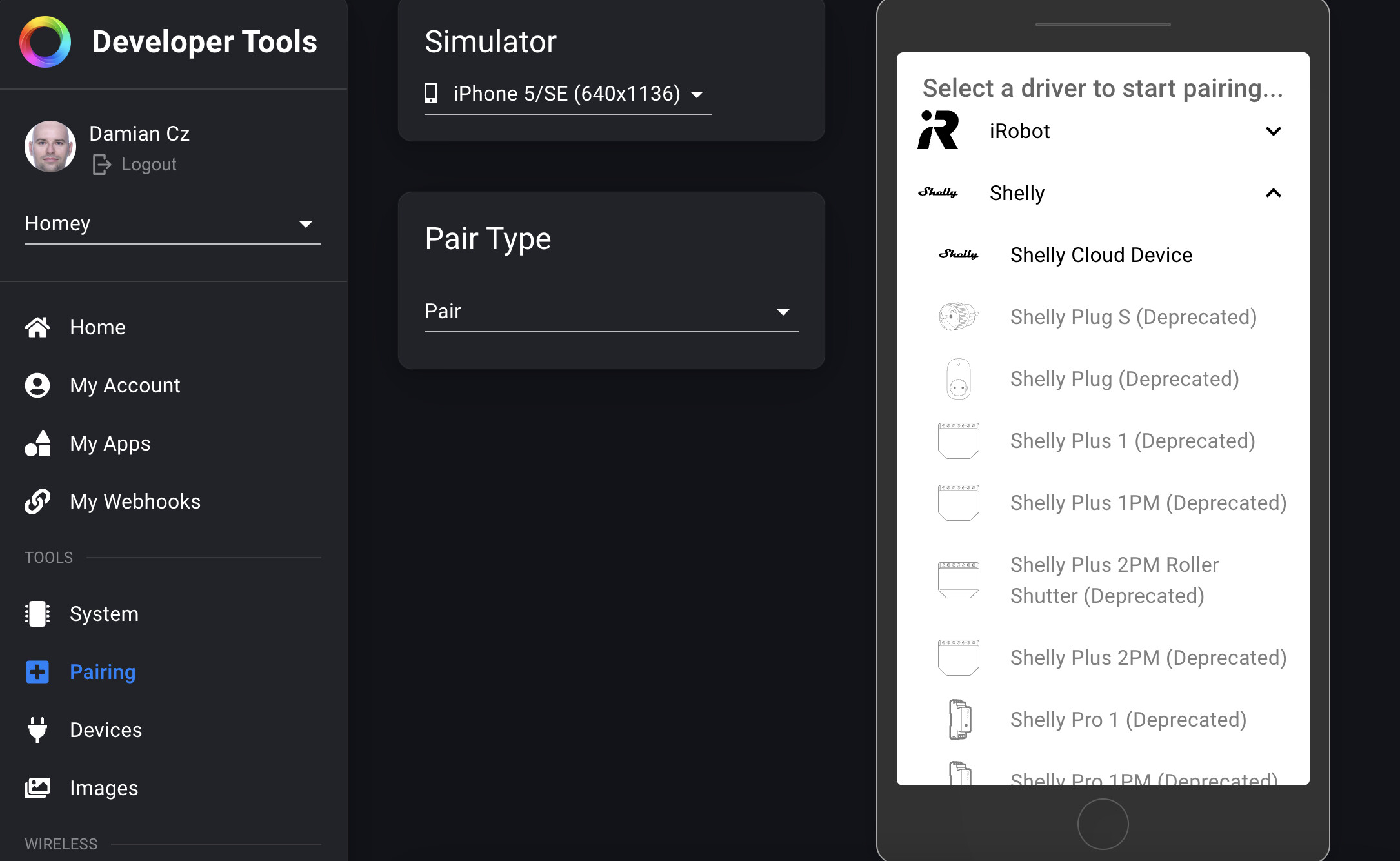

There is progress, there is no message about unavailable on Homey bridge, I can even choose the device I want to add, but after selecting nothing is added from the application level
I was able to add Shely Plus 1PM using Homey Developer Tools, but Shelly 2.5 cannot be added.

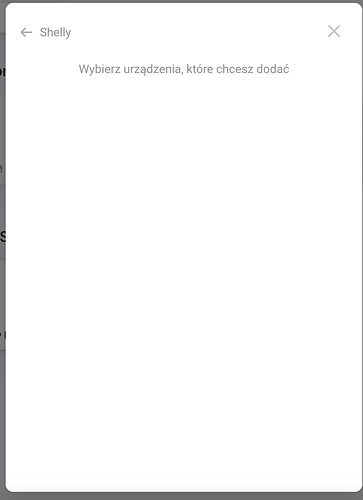

When I try to add shelly 2.5 relay to Homey Bridge, I can see this
I choose shelly 2.5 relay eg IP 192.168.1.96, a white page appears and nothing more like the screen below

As I added through Homey Developer Tools my two Shelly PM 1 Plus and chose a specific device and not shelly cloud, the devices work properly, as I choose as Cloud there is no reaction.

I added the Shelly 2.5 Relay test by selecting the device, not the Cloud, and unfortunately in this case it did not work

Thanx for reporting. Version 3.10.15 should fix this issue but it will require you to re-pair all multi-channel devices.
